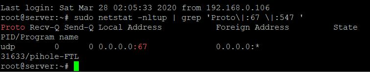

Below is a screenshot of sudo netstat -nltup | grep 'Proto|:67 |:547 '
Perhaps that provides some clues?
All prospective DHCP clients I've tested are connected directly to the router over WiFi. There is an extender but that also provides the same results, i.e no IPs assigned.
netstat results shows that Pi-hole is listening for DHCP on port 67, which is in line with your debug log showing you have full IPv4 connectivity. Pi-hole is also the only process on your Pi-hole machine doing so.
