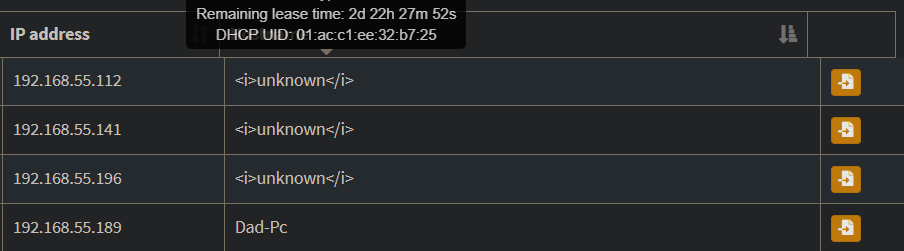

here, you can see the top three are unknown and the last one was identified correctly and not assigned statically or anything.
as for the cosmetic side, I know, I search for that before and saw a lot of people already reporting it.
do you need some other logs from the pihole? or is the log I uploaded enough?

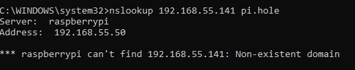

Does a reverse lookup for those IP addresses through your Pi-hole return any names, e.g.:
nslookup 192.168.55.112 pi.hole
image_2020-10-01_103757
So there is indeed no DNS record associated with that IP.
