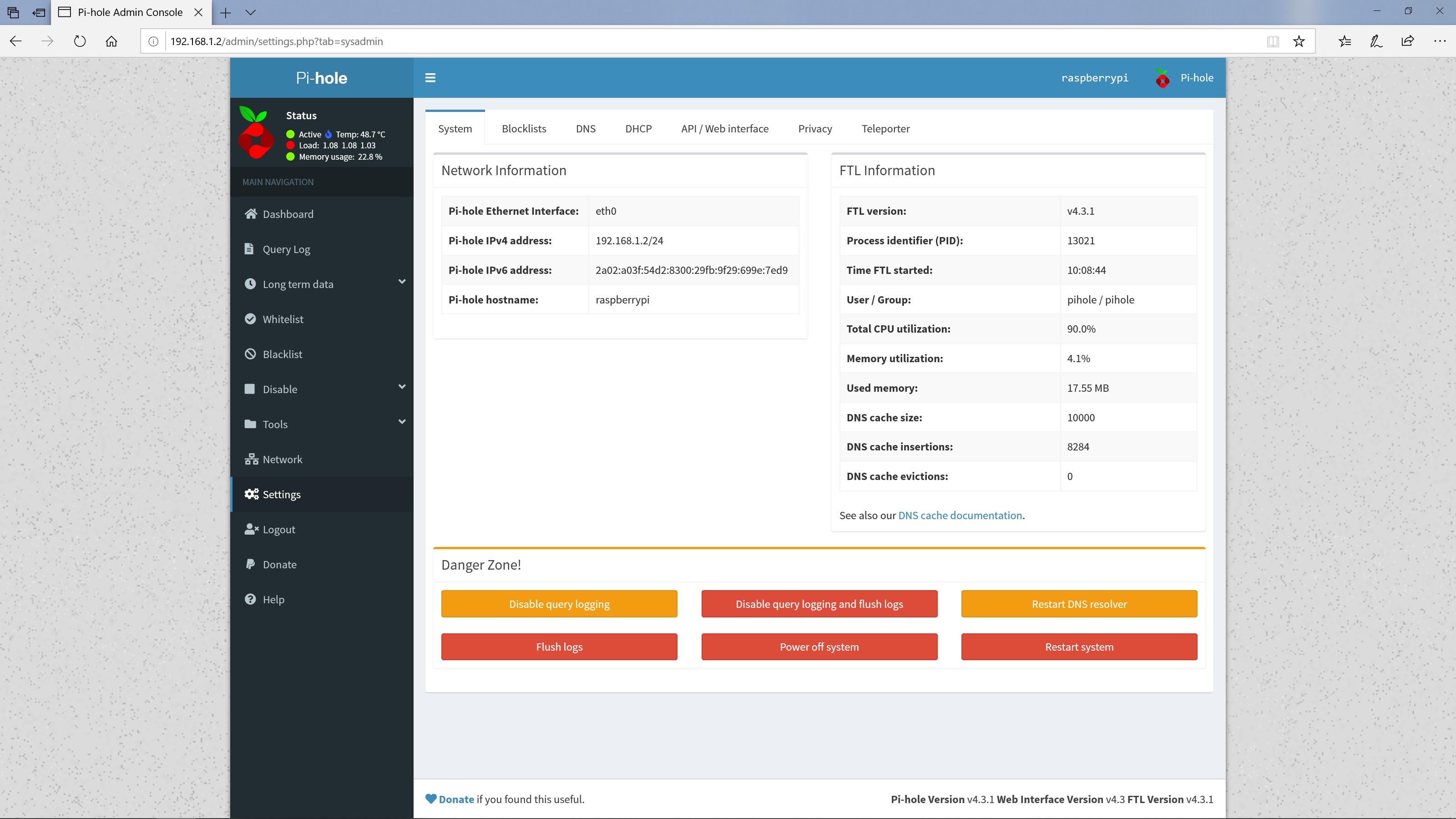

Just switched over.
Some further observations: in the DHCP part of PiHole dashboard, I see this line:
B8:27:EB:4F:89:4A 192.168.1.60 raspberrypi
Now, the pi has the IP address of 192.1.2 , connected to this MAC: 00:0e:aa:00:91:u5272: (according to the router etc)
Could this be linked to the cause?
