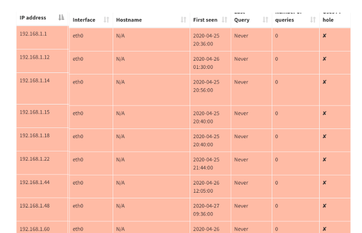

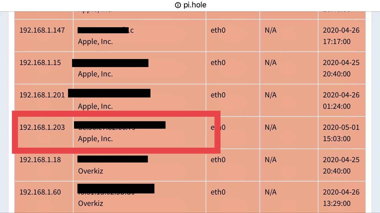

I have install Pi-hole on a raspberry pi4 and I have update my router to define my raspberry as primary DNS server but all my device are visible in pi-hole but with « use Pi-hile » = No
Seems that my devices are correctly connected.

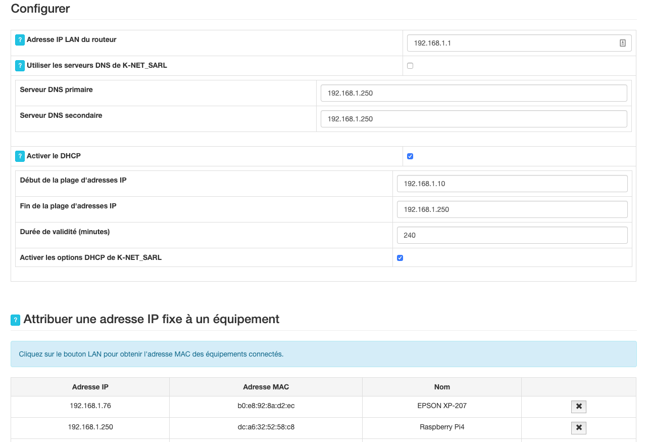

Hi deHakkelaar,
I am accessing internet thru a small French Internet provider called "K-Net", using their specific box.
You can find hereafter a screen shot of the configuration screen related to LAN:
I have defined 2 static addresses : one for my Raspberry running pi-hole (192.168.1 .250) defined also as Primary and secondary DNS server + one for a local printer (192.168.1.76).
Hope it can help.
Stéphane

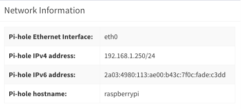

Here is a screenshot of the setting of Pi-hole interface:
My raspberry is connected thru ethernet so config is OK.
All my devices are well seen also on Interface eth0:
What is maybe strange is the Pi-hole IPv4 address : 192.168.1.250/24. Shouldn't it rather be only 192.168.1.250 ?

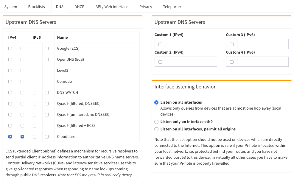

Here is the setting of my DNS:
Stephane
The IP address is being shown with it's subnet mask. The "/24" indicates that the subnet mask is 255.255.255.0. This is a normal display.

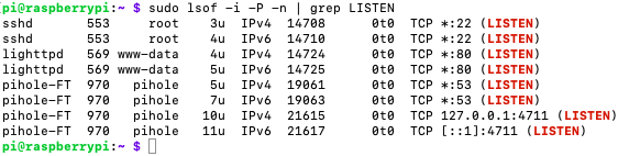

I made a scan of listening ports in my raspberry. Here is the result:
Are the two last lines for port 4711 correct ? (IP address)
IPV4 address for Pi hole is 192.168.1.250
Stéphane

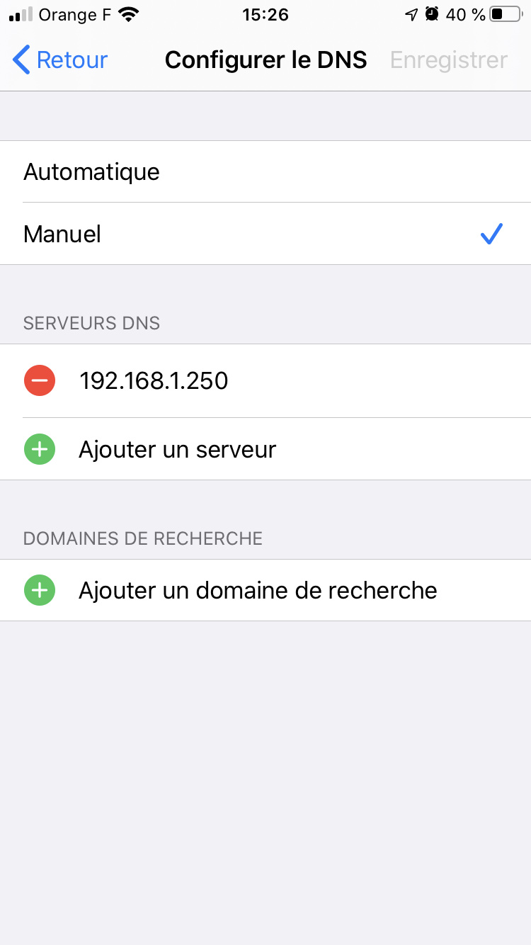

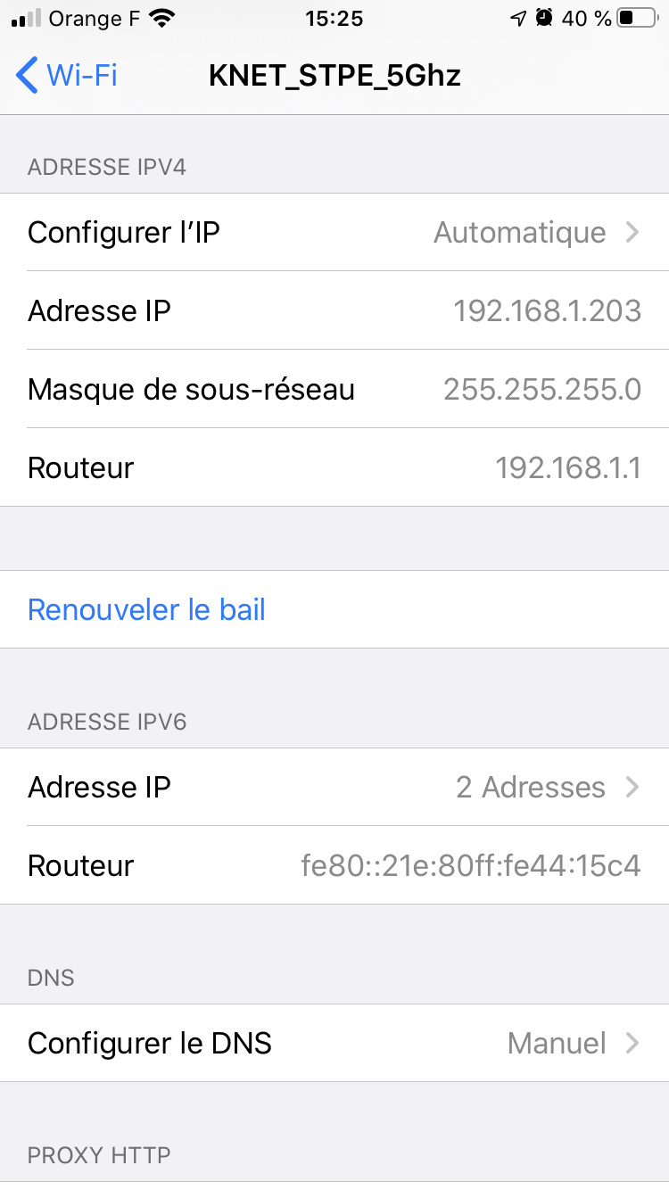

Could you manually verify if the devices (client) ip settings. There could be some time cache / DNS Set to Router's IP address. Try to reset that as well just in case, hope your client does not have DNS like 8.8.8.8 (Google' DNS)
Hi Dilip_prasad,
Here is the setting of my iPhone that should be using Pi Hole:
Everything should be ok for me... but my device is still seen as “Not Using Pi-hole”

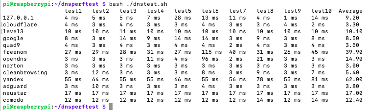

Here are the results of DNS Test:
Everything seems good.

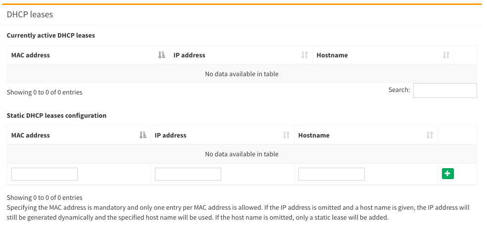

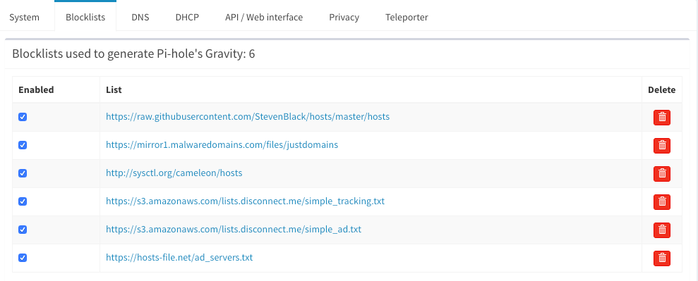

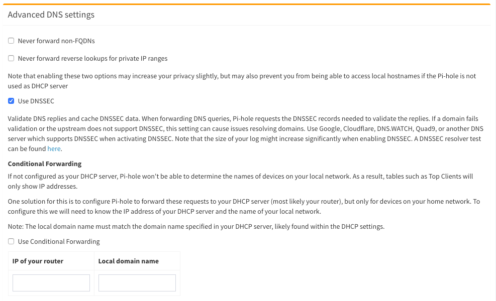

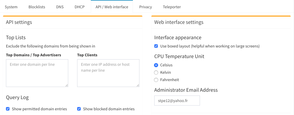

Here are some screenshots of Pi-Hole settings:
Hope you will be able to identify what I did wrong.
Stéphane

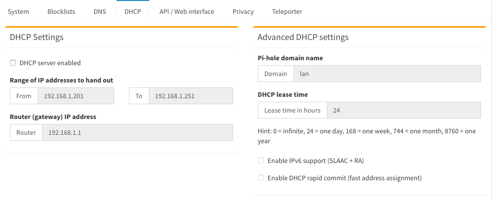

The end of Pi-hole settings:
Stéphane
