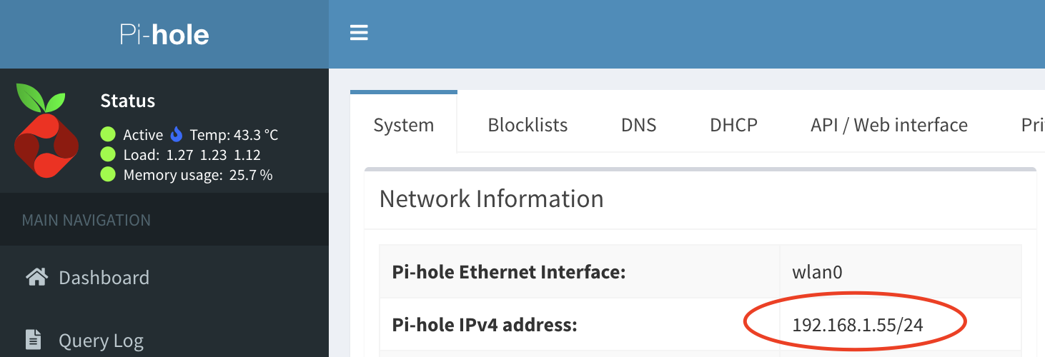

When I go to Pi-hole settings in the admin console on the Raspberry Pi, I see that:
Pi-hole Ethernet interface: wlan0
Pi-hole IPv4 address: 192.168.1.55/24
Pi-hole IPv6 address: blank (i didn’t enble IPV6 DHCP)

I might have found the problem. The Raspeberry Pi has an IP of 192.168.1.56 reserved, but Pi-hole is showing its IP as 192.168.1.55. Do I just need to make those two configurations are the same IP?

Do I need to make sure that Pi-hole's IP and the Raspberry Pi's IP are the same? Pi-hole has IP of 192.168.1.55 but Pi's IP is 192.168.1.56.

So really my last question is as follows:
Should the IP here:
Be the same as the IP I reserved for my Raspberry Pi via my router, and that outputs when I run ifconfig?
Right now, the former is 192.168.1.55, and the latter is 192.168.1.56. I can easily make them the same (either by changing it on the Pi-hole side to .56, or on the Pi/router side to .55), if that's something I should be doing.
Yes and no. :wink:
That admin panel section draws the bulk of its information from a file with Pi-hole's defaut settings that get's created on first run.
As you have changed your network setup intermittently, that information is likely lagging behind - a left-over, as I said :wink: - and just a display issue, mostly.
To fix this, run pihole -r.
Or edit sudo nano /etc/pihole/setupVars.conf and replace the IP address in the IPV4_ADDRESS line with the address as assigned by your router and shown for eth0 by ip addr (those two must match, however).
Made the change to eth0, modified the IPV4_ADDRESS, restarted Pi-hole, and now everything works swimmingly :slight_smile:
