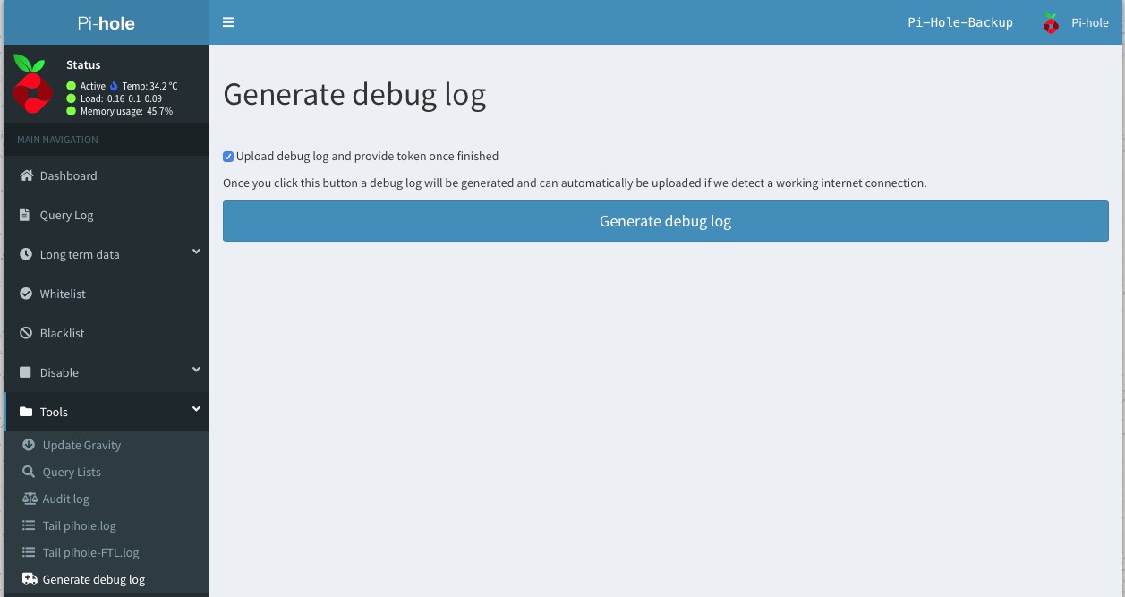

If your debug log is required to help analyzing a problem, a forum moderator will ask you to upload it and provide a token, e.g. by Tools | Generate debug log using Pi-holes UI. A mod or developer can use that and access and read your log.
Uploading the log instead of posting it here in the forums directly offers the advantage of not leaking your potentially sensitive configuration data to the public.
There are no benefits from performing an upload if you don't have a problem. You can always have a look at its last output under /var/log/pihole_debug.log.
When you generate a debug log, you will be prompted to upload it. If you select "Y" or "Yes", then the log uploads to a Pi-Hole server. After the log uploads, you will receive a token. You send us the token (typically in a post or reply) and we use that to find your debug log on the server.
Depending on how you generate the debug log, the prompt to upload appears either at the beginning or the end. From the web admin, it's a checkbox at the beginning:
From the terminal with the command pihole -d , the prompt is at the end:
