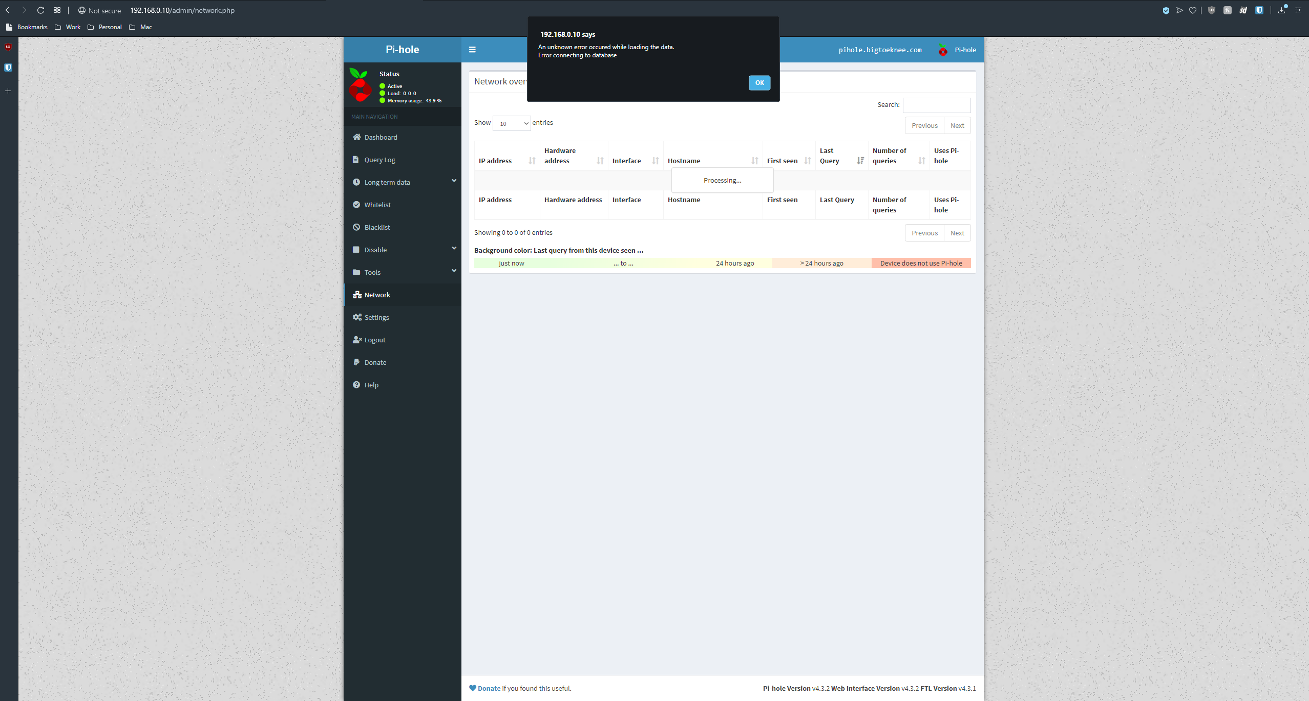

Databases unable to read anything blocking isnt working either
[blocking of ADs and able to see data in the web interface]
[Not seeing any data and get errors when accessing blocklists and trying to query logs. I see no logging at all when trying to tail from web interface]

Would this be the same reason that the networking tab is failing as well?
If you've installed that package and the page is still not functioning then paste a screenshot of the page and a new debug token.

I did install php-json which gave me the graphs and info there just this piece is the only thing not functioning.

   [2020-01-14 11:39:22.336 24181] SQLite3 message: cannot open file at line 38452 of [0eca3dd3d3] (14)
   [2020-01-14 11:39:22.336 24181] SQLite3 message: os_unix.c:38452: (2) open(/etc/pihole/pihole-FTL.db) -  (14)
What does
ls -lh /etc | grep pihole
ls -lh /etc/pihole/*.db
say?
drwxr-xr-x 2 pihole pihole 4.0K Jan 14 15:22 pihole
-rw-r--r-- 1 root root 2.3M Jan 14 11:34 /etc/pihole/macvendor.db
-rw------- 1 pihole pihole 300K Jan 14 15:22 /etc/pihole/pihole-FTL.db
Okay, how about
sqlite3 /etc/pihole/pihole-FTL.db "SELECT COUNT(*) FROM network;"
Also, please run
sudo chmod ga+r /etc/pihole/pihole-FTL.db
and check again the dashboard.
That did it! Thank you! fully functional now. Appreciate it!
