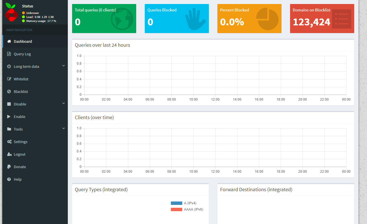

I am currently trying to install PiHole on my synology using docker. After a couple rounds of the various instructions I have settled on using this docker run command
sudo docker run -d --name=pihole -v "/volume1/docker/pihole/:/etc/pihole/"
-v "/volume1/docker/dnsmasq.d/:/etc/dnsmasq.d/"
--net=host
-e ServerIP=192.168.1.99
--restart=always
-e DNS1=8.8.4.4
-e DNS2=8.8.8.8
-e IPv6=False
-e VIRTUAL_SERVER=192.168.1.99
-e WEB_PORT=37337
-e DNSMASQ_LISTENING=all
-e WEBPASSWORD=randomLetters!
diginc/pi-hole:latest
I have also set up Webstation to serve the pihole reject image.
Everything appears to work well from a functionality sense, it is serving dns addresses and blocking appropriate ones, but the web UI looks like the following.
Any ideas on how I can get the web UI to function correctly?

I have exactly the same problem since the last release. However, I'm running it on a raspberry pi 3.
No statistics are shown on the dashboard and no long-term logs are available - "Query log" throws a popup message indicating "An unknown error ocurred while loading the data". Everything was working before the update.
"pihole -d" shows nothing special.
