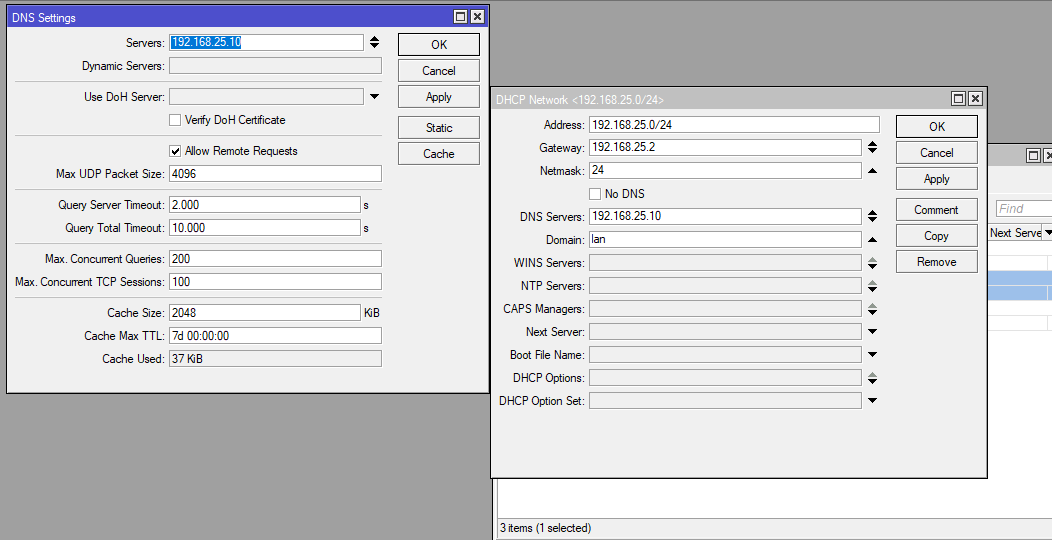

I've configured Conditional Forwarding in Pi-Hole (192.168.25.10). Set my Mikrotik IP (192.168.25.2) and the local domain name ("lan").
In Mikrotik DHCP settings, Pi-Hole is set as the Primary DNS Server and the specific network has the Domain configured as "lan".

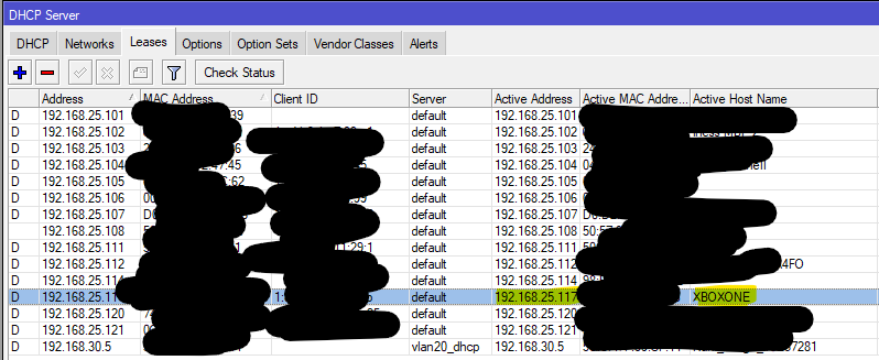

I've confirmed and the IP's that I tried to resolve, are properly populated in the DHCP Lease table of the Mikrotik.

I have that option enabled. But I'm not using the router as the DNS server itself. Both in DNS settings and DHCP settings, the DNS server is Pi-Hole.
Should I set the clients to connect via the Mikrotik DNS (192.168.25.2), which in turn will send those requests to Pi-Hole (192.168.25.10)?

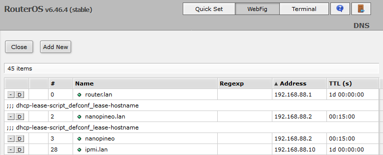

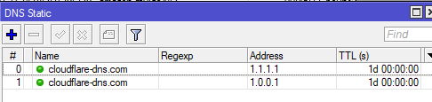

What does your DNS tab look like for static DNS?

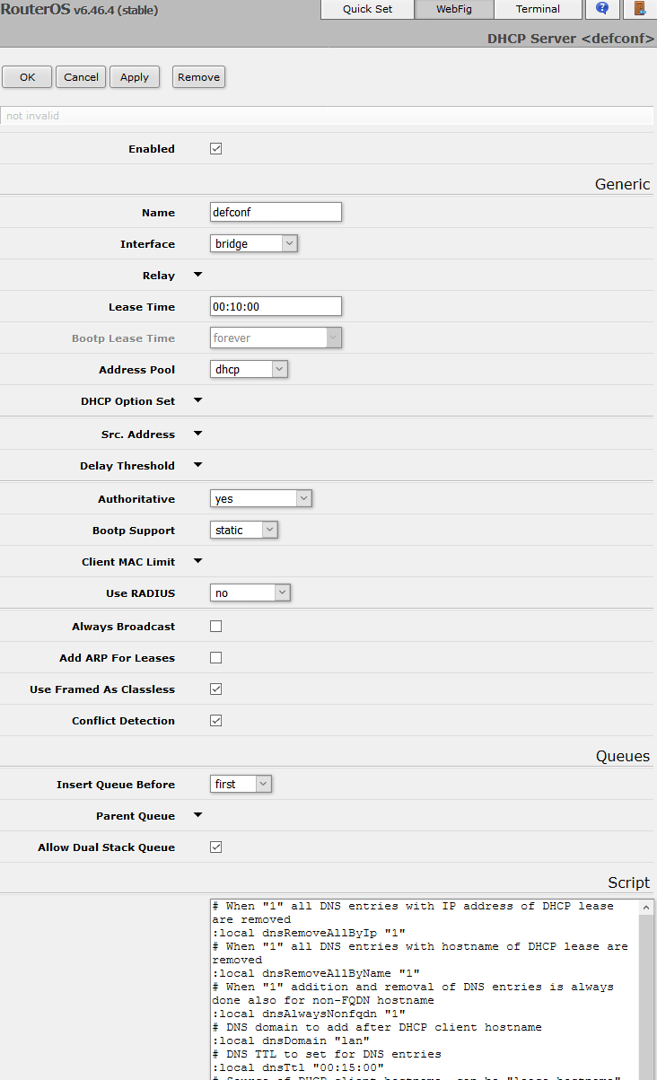

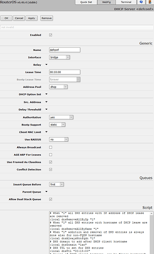

Ah, that's the problem. MTik DHCP server doesn't automatically populate the DNS static entries with client names. Needs some "tricks". Check the script attached (modify for your local domain name preference.)
# When "1" all DNS entries with IP address of DHCP lease are removed
:local dnsRemoveAllByIp "1"
# When "1" all DNS entries with hostname of DHCP lease are removed
:local dnsRemoveAllByName "1"
# When "1" addition and removal of DNS entries is always done also for non-FQDN hostname
:local dnsAlwaysNonfqdn "1"
# DNS domain to add after DHCP client hostname
:local dnsDomain "lan"
# DNS TTL to set for DNS entries
:local dnsTtl "00:15:00"
# Source of DHCP client hostname, can be "lease-hostname" or any other lease attribute, like "host-name" or "comment"
:local leaseClientHostnameSource "lease-hostname"
:local leaseComment "dhcp-lease-script_$leaseServerName_$leaseClientHostnameSource"
:if ($leaseClientHostnameSource = "lease-hostname") do={
  :set leaseClientHostname $"lease-hostname"
} else={
  :set leaseClientHostname ([:pick \
    [/ip dhcp-server lease print as-value where server="$leaseServerName" address="$leaseActIP" mac-address="$leaseActMAC"] \
    0]->"$leaseClientHostnameSource")
:local leaseClientHostnameShort "$leaseClientHostname"
:local leaseClientHostnames "$leaseClientHostname"
:if ([:len [$dnsDomain]] > 0) do={
  :set leaseClientHostname "$leaseClientHostname.$dnsDomain"
  :if ($dnsAlwaysNonfqdn = "1") do={
    :set leaseClientHostnames "$leaseClientHostname,$leaseClientHostnameShort"
:if ($dnsRemoveAllByIp = "1") do={
  /ip dns static remove [/ip dns static find comment="$leaseComment" and address="$leaseActIP"]
:foreach h in=[:toarray value="$leaseClientHostnames"] do={
  :if ($dnsRemoveAllByName = "1") do={
    /ip dns static remove [/ip dns static find comment="$leaseComment" and name="$h"]
  /ip dns static remove [/ip dns static find comment="$leaseComment" and address="$leaseActIP" and name="$h"]
  :if ($leaseBound = "1") do={
    :delay 1
    /ip dns static add comment="$leaseComment" address="$leaseActIP" name="$h" ttl="$dnsTtl"
