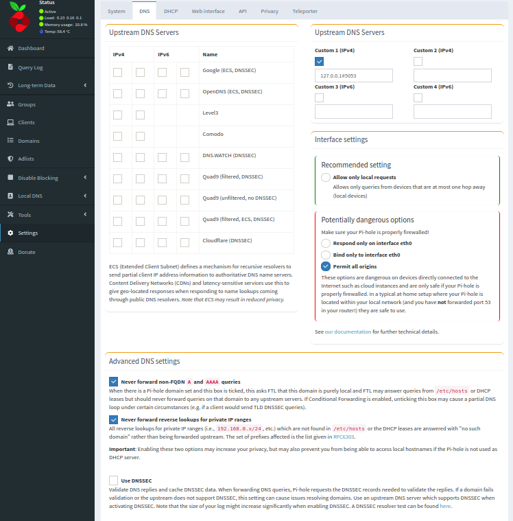

Pihole doesn't forward my queries to upstream Cloudflared DNS server.
Details about my system:

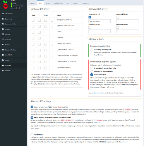

I am using Pihole on a raspberry pi 4. I am also running an upstream DNS Cloudflared server in port 5053 in order to use the Encryption over Https(DOH).

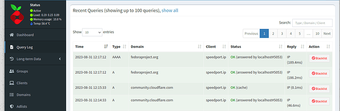

The problem is that the status of my queries are OK (answered by localhost#5053) and NOT OK (forwarded to localhost#5053).

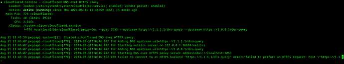

In the third picture the following error appears:
failed to connect to an HTTPS backend "https://1.1.1.1/dns-query" error="failed to perform an HTTPS request: Post "https://1.1.1.1/dns-query\": context deadline exceed> (Client.Timeout exceeded while awaiting headers)"
Also to note is that for query "fedoraproject.org" my client is 192.168.1.68 but in the query log it lists my router client 192.168.1.1.
Does anybody know how to resolve this? Do you think this is a network issue?
That's normal. From Pi-hole's perspective it is getting its answers from its upstream server(s) which in your case is localhost#5053.

That's cloudflared's ERR message.
A precursory search in their forums turns up some hits, e.g. https://community.cloudflare.com/t/cloudflared-access-login-works-but-returns-timeout-error/412033
You should consider to also consult Cloudflare's community for support.
