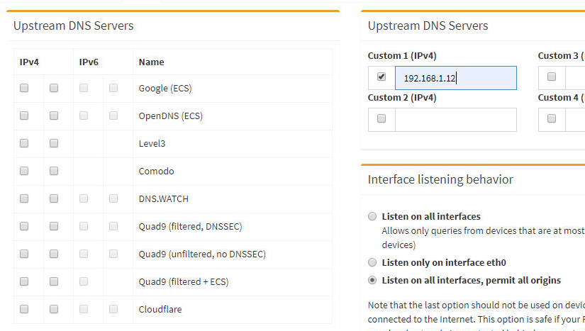

In your Rpi, you need to select a valid upstream server.
Putting the IP of (what i assume is) your Pi-hole as a custom, will not work as it throws it in a loop (and that's why it's not working).
Just select a few/some from the right and unless you're using unbound, disable the .12 as your custom.
If you really want to not depend of a public DNS resolver as your upstream, you can always use unbound locally and go that route.

I was setting the Customer Upstream server as per the instructions, Method 2. Don't know if these instructions are outdated with the latest updates.
Anyways I removed the Custom Upstream server and selected to use the Cloudfare servers. I also removed the secondary DNS servers in my Router > Basic > Network > "Static DNS" fields and my clients still aren't connecting to the Pihole after a ipconfig /renew + ipconfig /flushdns + router reboot + RPi reboot.
