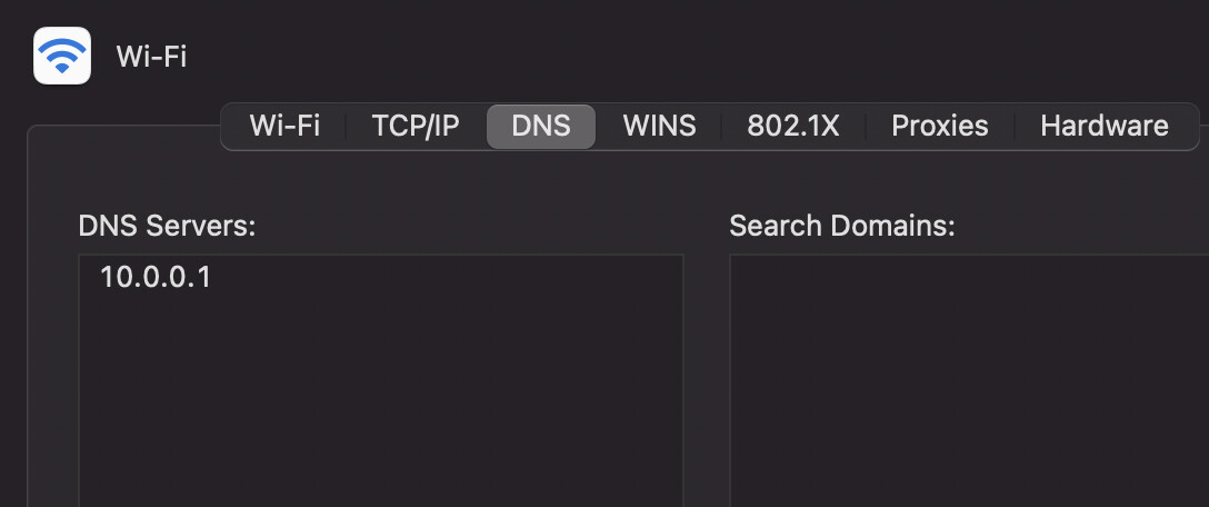

Just in case I'm doing something wrong on the client, here are my client settings:
FWIW, my macbook network configuration looks like this:
And, the DNS alternates between 10.0.0.1 or 10.0.0.50, depending upon whether or not I'm trying to use the pihole for DNS, which in order to reply to the post, I have to be using the router's address atm:
