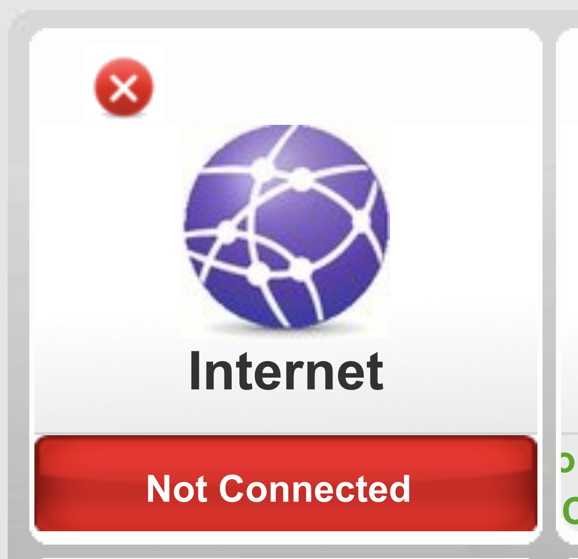

The WiFI was already disabled, according to raspi-config. I ran the commands and updated the DNS on the router. This is what happens on the router.
