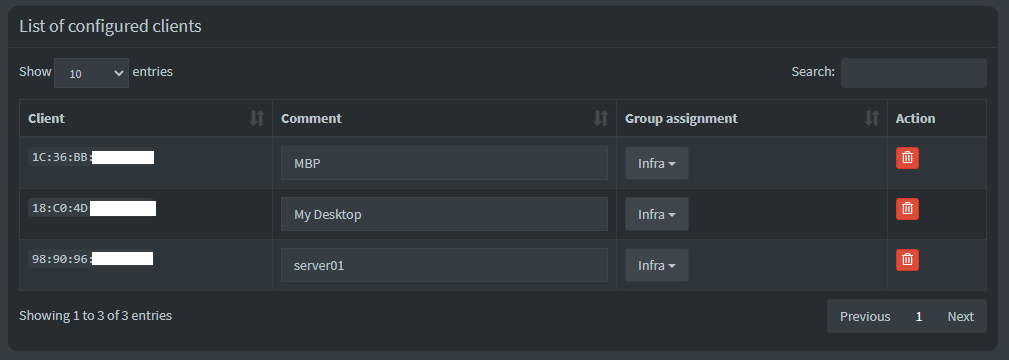

I'm running into a strange issue on a clean PiHole install. I noticed that when I am adding clients in the 'Clients' menu under 'Group Management', so that I can later add them to various groups, the 'List of configured clients' table is showing them all by their mac address only, not by IP or hostname anymore. The only way I'm able to add any sort of meaningful label is via the comment box. I could have sworn I had them all listed by IP/hostname on my last PiHole instance.

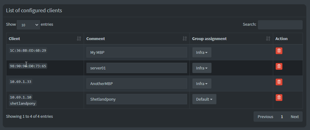

@yubiuser I am actually not sure that the table is working as intended. When you add a new client by selecting a 'known client' from the drop down, it only inputs the mac address into the 'List of Configured Clients' table. However, if you just type an IP address into the add client field, without selecting the search result from the drop down, it puts the IP & hostname (if known) into the table..as seen in my screenshot below.
The top 2 results are clients I selected from the drop down, the bottom 2 are ones that I manually typed in the IP address and DID NOT select the returned result from the dropdown. As you can see, my PiHole knew of one of the two hostnames, and listed it in the appropriate field.
very interesting. hadn't thought of trying that.
I can confirm the behavior. It is not very consistent, I'll check with the developers.
