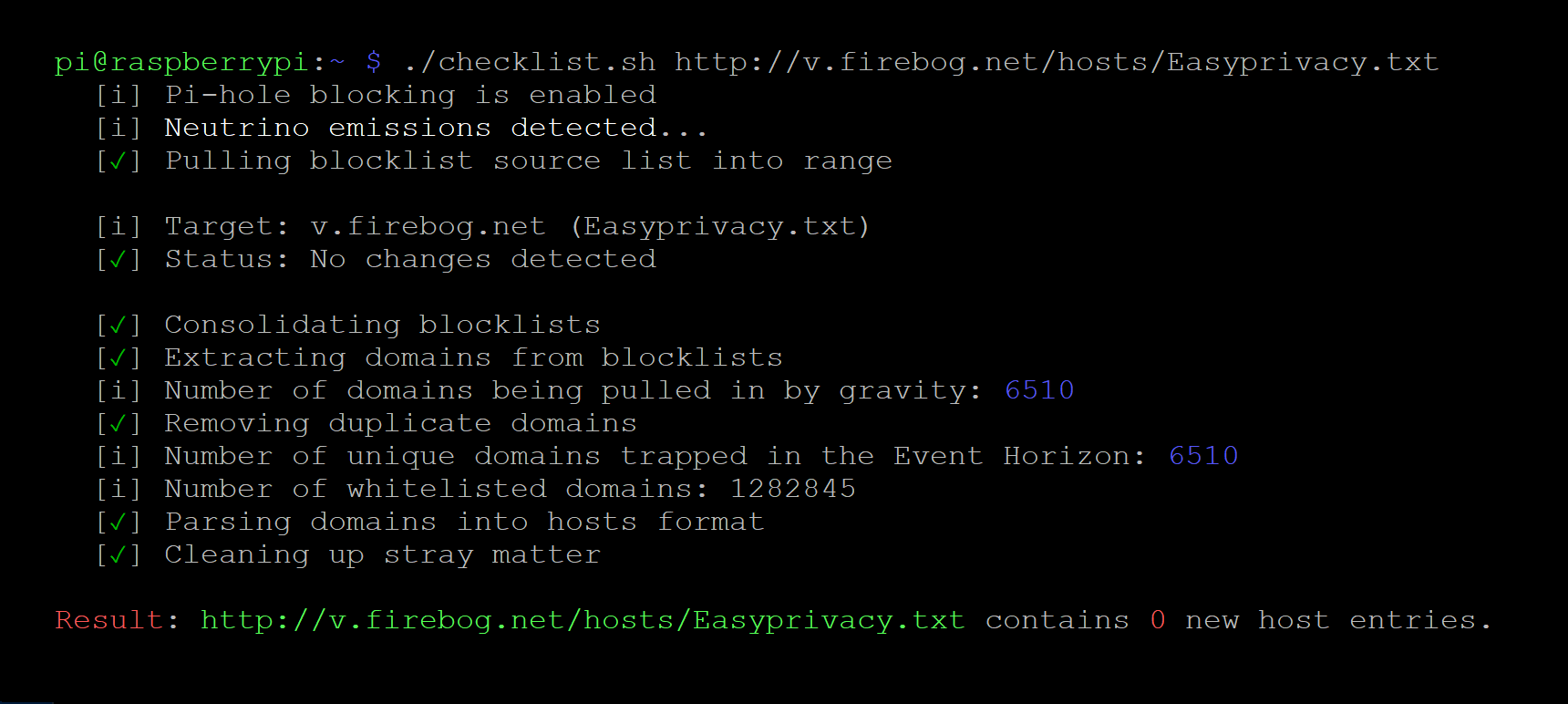

To check the added value of new lists, I've written a script that uses gravity.sh (part of pihole) to determine if there would be any new entries in gravity.list (the list pihole-FTL uses to block ads).
The script creates a new directory in /etc. No way this can be changed, gravity.sh will complain if this is not the base directory.
The new directory is /etc/checklist. All necessary files will be copied or created by the script.
It is possible to use tmpfs, thus saving wear and tear on your SD card. To enable this, you need to uncomment useramdrive (line 46). To remove the ramdrive, follow the instructions in the wiki
As an example, I'm running the script with a new list, this is the result:
As you can see, in my setup, there is no added value to adding this list, there are 6510 entries in the list, but it contains 0 new hosts.

According to my screenshot, there are actually 6510 valid entries in this list.
As I tried to explain:
  • I have an adlists.list that contains a number of lists. When pihole -g runs on sunday (cron), a new gravity.list is created on MY system (unique, because it is created, using MY adlists.list).
  • You probably have a very different set of lists in your adlists.list file, or if you haven't added any, you would use the default lists, as provided during the pihole installation. When pihole -g runs on your system, a new gravity.list is created on YOUR system (unique, because it is created, using YOUR adlists.list).
The script calculates the number of entries that would be added to the, already existing /etc/pihole/gravity.list on the system it runs.
The result of the script will vary on different installations of pihole. On MY system, there wouldn't be any additional entries. On YOUR system, it appears this list might be useful (about 4000 new entries).
