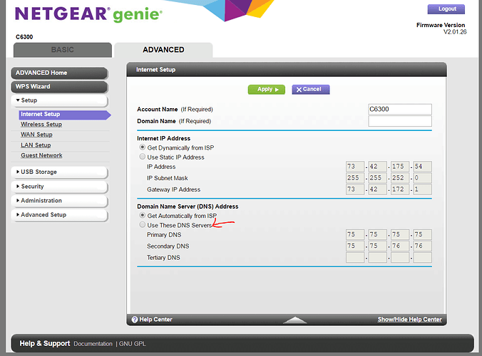

When I go to my router settings (Netgear Genie) to change the DNS server to Pi-hole's DNS, it does not accept it:
So I click on "Use These DNS Servers" and then change the Primary IP to 198.168.0.33 (which is my RPi's ip). I have the pi connected to the router/modem by ethernet, too. However, after hitting apply, it says:
I don't think this is Pi-hole's problem, though. Even when I try replacing the ip's with 8.8.8.8 (primary) and 8.8.4.4 (secondary), it says, "Invalid IP address." How should I proceed?

Many routers do not let you specify DNS servers located on the LAN network that they host. The router enforces an upstream DNS provider that it can access via the WAN. Unfortunately in many cases these same routers have no option to change the DNS used on the local network.
You're in luck though because your Netgear C6300 allows you to disable DHCP service (which is how DNS addresses are provided to the networks). On the C6300, the settings to do so are in "LAN Setup", where you would have to uncheck "Use Gateway as DHCP server".

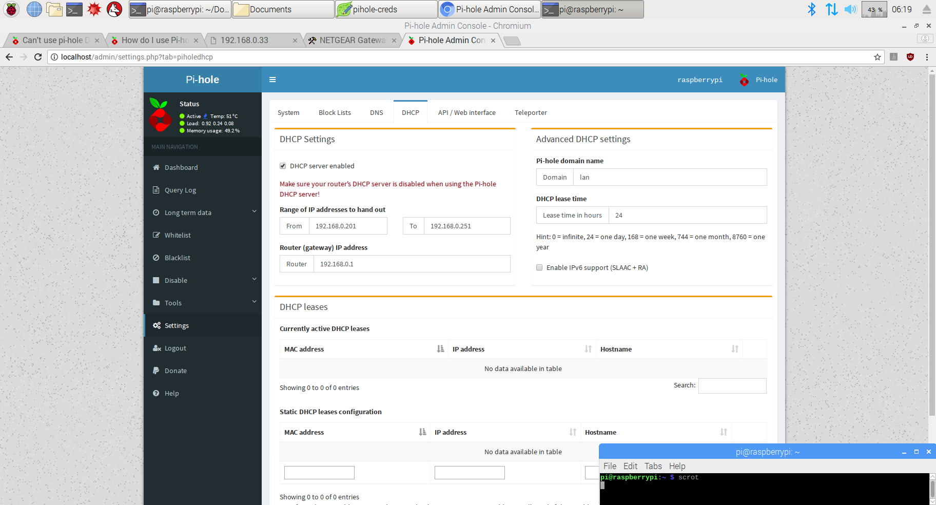

Can you post a screenshot of your settings on the Pi-hole DHCP Settings page?
This is a picture of the DHCP settings page:

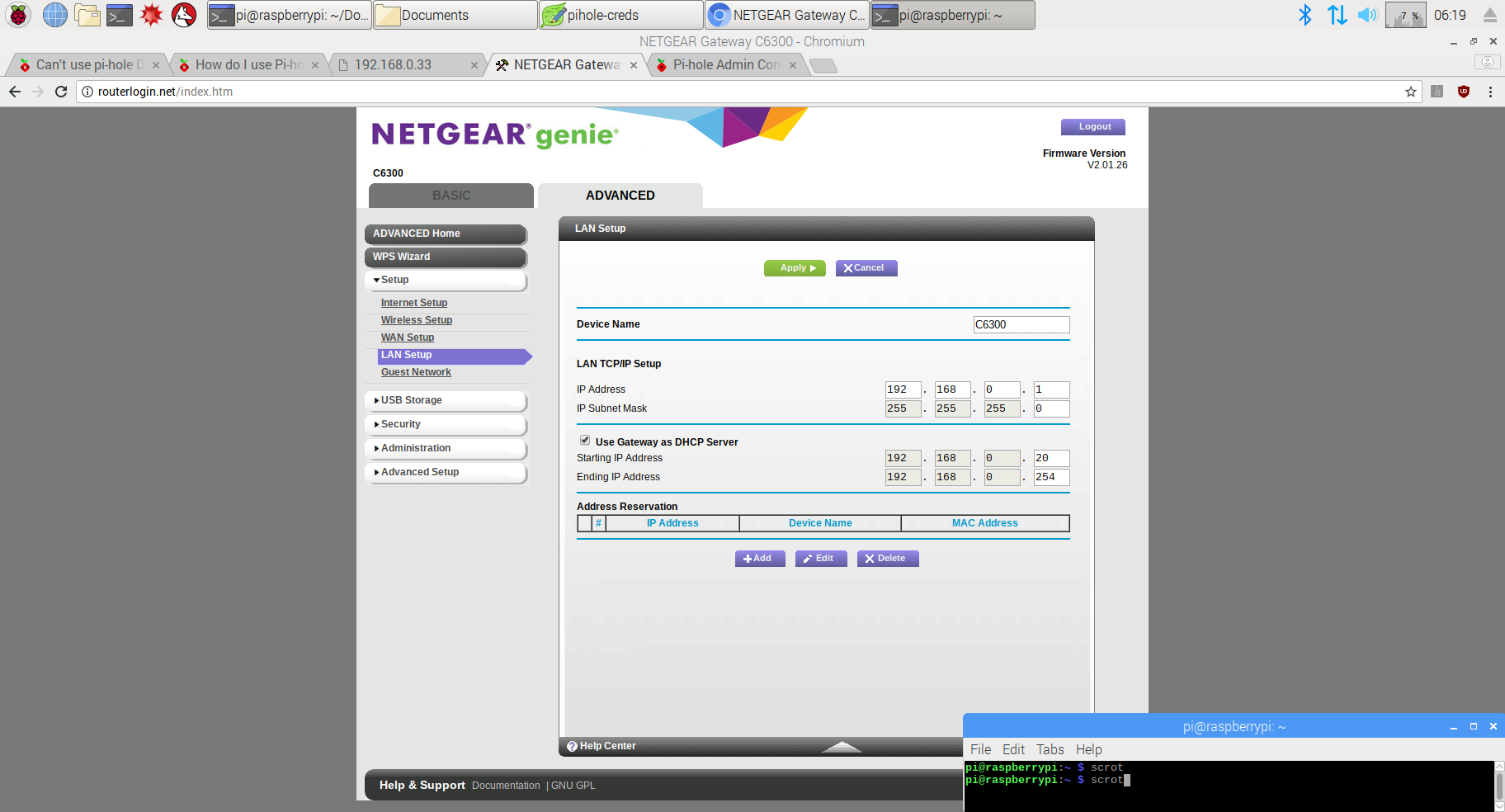

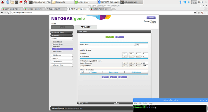

And here is what I changed on my router:
Un-check the router DHCP serving.
Also I think you need to expand the Pi's DHCP address range.
I did uncheck "Use Gateway as DHCP Server," but will expanding the Pi's DHCP range solve the problem? And what should I expand it to?
I would expand it to include everything. Not sure how you can reserve static address (if needed, like for the router itself), but I am sure is possible.
