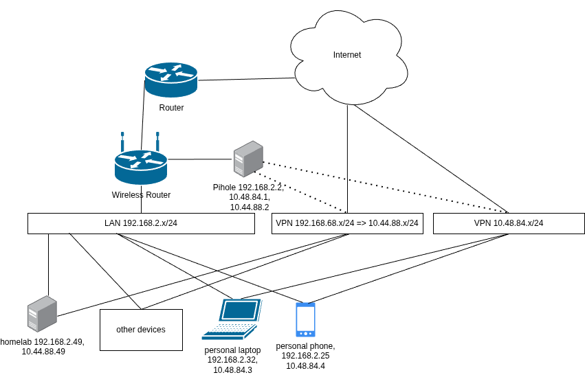

OK, then before we continue maybe you could show us a drawing of your network setup first ?
Right now I don't really have a clear picture of the whole setup and it's hard to suggest anything useful :slight_smile:

sure,
Here it is roughly:
not sure how to really depict it as the 2 vpn ips sort of overlap but the 10.48.84.x range has access to 10.44.88.x even though devices under the latter ip range dont have ips in the range of 10.48.84.x. Also the 2 routers there is a double port forward. I dont live alone so I needed to keep the ISP router for stuff like television, even though everything is connected on the inner network.
Hopefully this helps.
