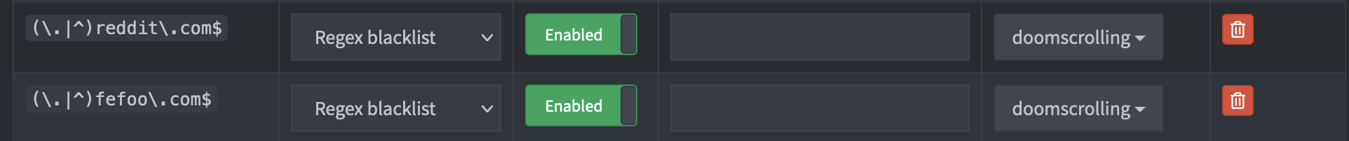

I added two wildcards to a group blacklist called 'doomscrolling', and added a client to that same list. I expect that that client would not be able to look up hosts matching the wildcards.

This time I put *.reddit.com in both default and doomscrolling:
 id     type  enabled  group_ids     domain                                                                                                date_added           date_modified        comment
 1        2         1  0             (\.|^)newrelic\.com$                                                                                  2021-05-08 07:36:11  2021-11-28 17:05:46
 12        3        1  3             (\.|^)reddit\.com$                                                                                    2021-11-28 07:38:25  2021-11-28 17:05:52
 13        3        1  3             (\.|^)fefoo\.com$                                                                                     2021-11-28 07:38:36  2021-11-28 17:05:56
As far as I can tell I have configured things correctly.

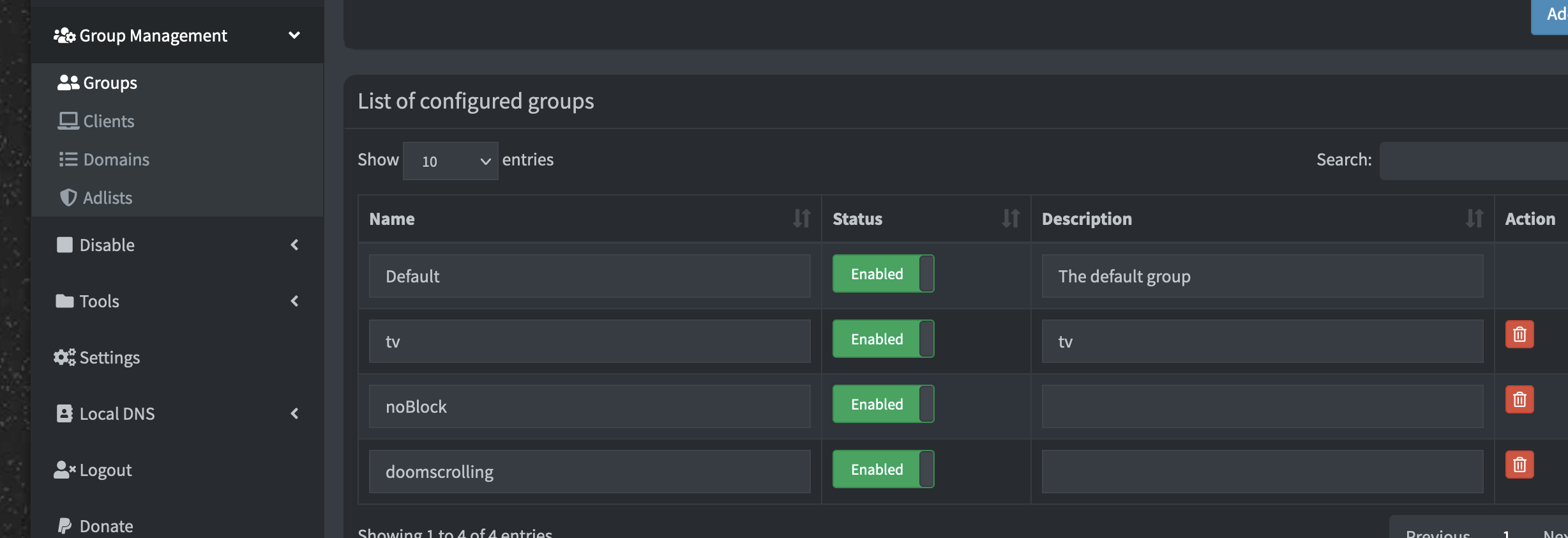

  • The doomscrolling group exists:

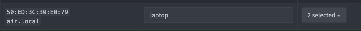

My laptop (MAC ends in eo:79, aka air.local) is in it:

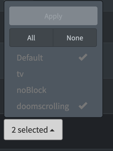

(2 selected):
The two wildcard blocks I want are in the doomscrolling group:
and yet it doesn't work.

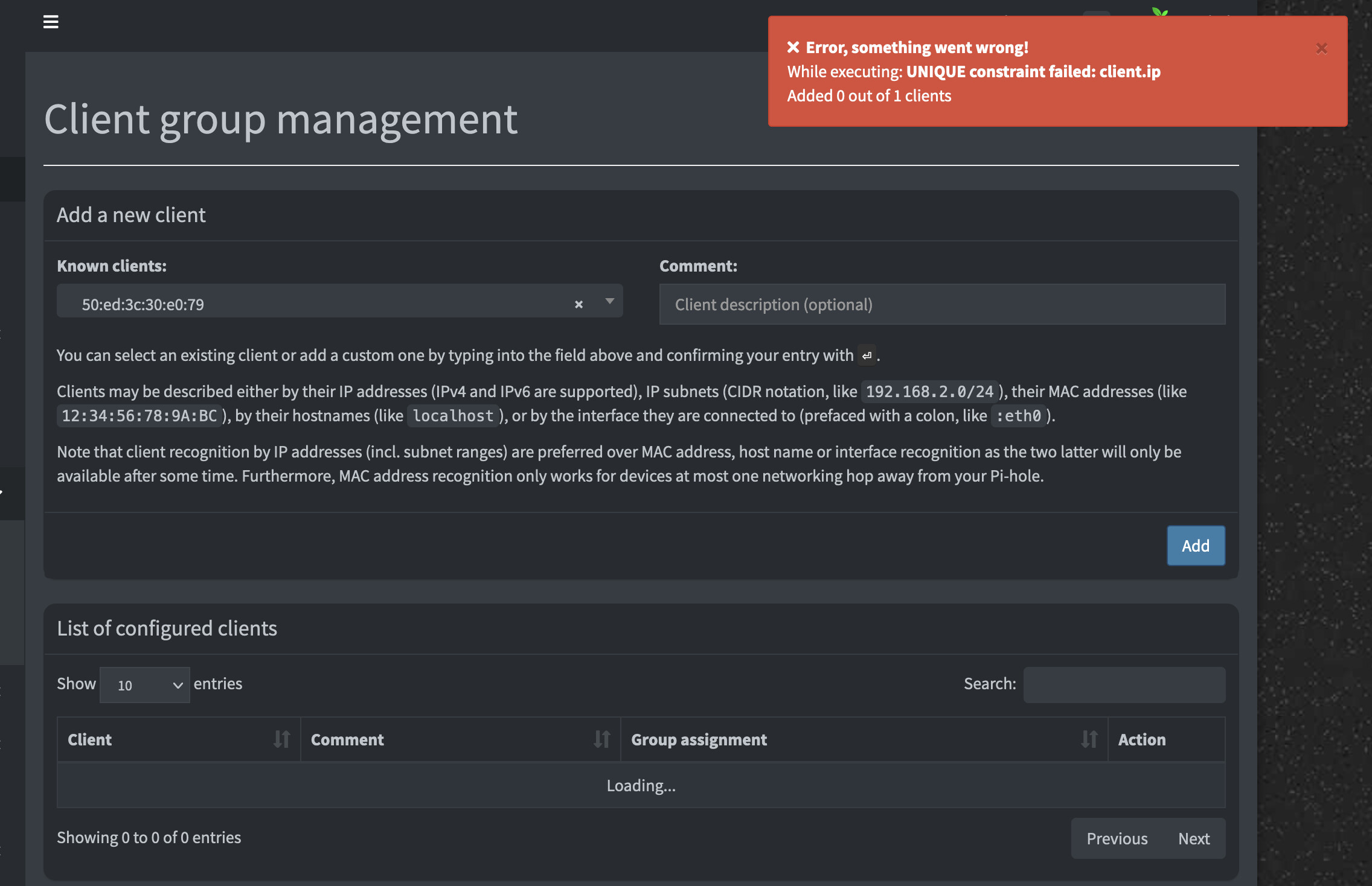

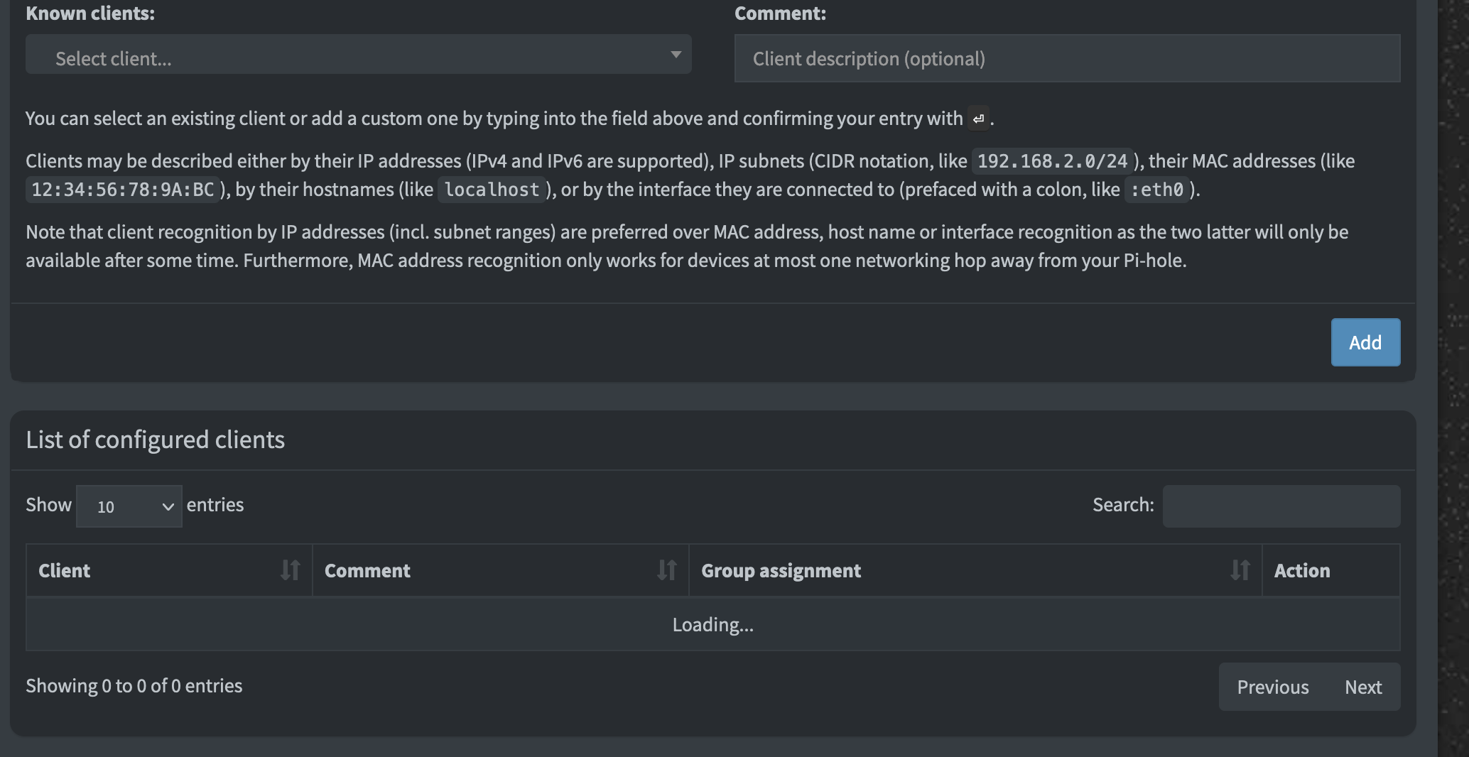

I then tried to add my laptop by finding it in the dropdown box and the GUI reported that it successfully added the MAC associated with it, but the list of configured clients still reports zero.
I have to guess that this smells like a corrupted database or something, but now I'm out of my element.
