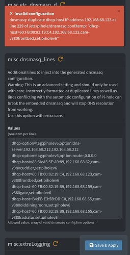

However, whenever I paste in the relevant lines & press the 'Save & Apply' button, it generates an error (as shown in the attached image):
Invalid configuration
dnsmasq: duplicate dhcp-host IP address 192.168.68.123 at line 230 of /etc/pihole/dnsmasq.conf.temp: "dhcp-host=60:FB:00:82:19:C4,192.168.68.123,cam-v380frontbed,set:piholev6"
It won't let me save the edits.
Do I need to delete something somewhere to allow these edits to be Saved & Applied ?
I think I've figured out the reason, it's because the WiFi cameras MAC & IP's are also defined in the 'dhcp.hosts' settings (ie. in the set of Static DHCP IPs).
Pi-hole v5 never had a problem with the MAC/IP's in the Static DHCP list & also defined in the /etc/dnsmasq.d/*.conf files
I do find Pi-hole v6's management of Static DHCP IP's to be somewhat 'painful' :frowning:

Remove any related lines from misc.dnsmasq_lines
Instead, you can keep using your custom files if you enable misc.etc_dnsmasq_d, see also V6 - Post release fixes and findings.
Just make sure the files exist under /etc/dnsmasq.d/, and Pi-hole has permission to access them.
Thanks for the help.
Actually I did the opposite - I added the few lines I wanted to misc.dnsmasq_lines in Pi-hole v6 & just abandoned the /etc/dnsmasq.d/*.conf files. That seems to have done what I wanted (which was basically to give my WiFi cameras a different DNS host to the rest of my LAN).
