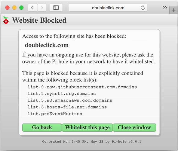

So I've set my phone and laptop to pihole DNS, my laptop indeed gives 404-like errors (but that means it works as expected), however, my phone (chrome browser on android) is letting ads through.
You can try see how the blockpage looks like by browsing to below link:
http://doubleclick.com:8899

Well it should have returned below or similar (no idea why the error):

I've just configured lighttpd to use port 80
And NGINX to use port 8888
This actually works fine for my purpose, also the error dissapeared and I now get a user-friendly blockpage.
