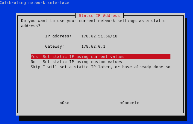

On systems with dhcpcd, the Pi-hole installer would offer to set an IP for you (mostly, Raspberry Pi OS up to RPi OS 10) via a dialog:
Choosing 'No' in that dialog should allow you to enter a custom IP.
If you do not see that dialog, then Pi-hole would not touch your system's network configuration, but use whatever IP address is already configured for your system.
