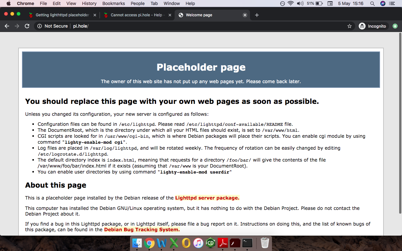

When trying to access http://pi.hole or http://pi.hole/admin, I should be able to access the admin page.
When browsing to http://pi.hole or http://pi.hole/admin, I get the placeholder page. When I don't include http://, I get 403 forbidden.

What placeholder page are you getting? Please post a screen shot of what you are seeing, including the address window in the snap. In this forum you can paste a screen capture directly into a reply.

@jfb:
Here's http://pi.hole
And here's pi.hole/admin
Your /etc/lighttpd/lighttpd.conf file is not the one installed by the pi-hole.net distribtuion of Pi-hole. From what source did you install your Pi-hole?
