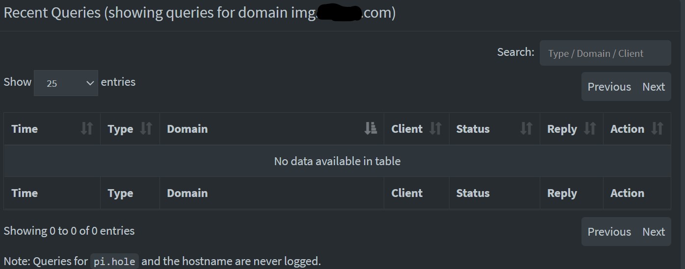

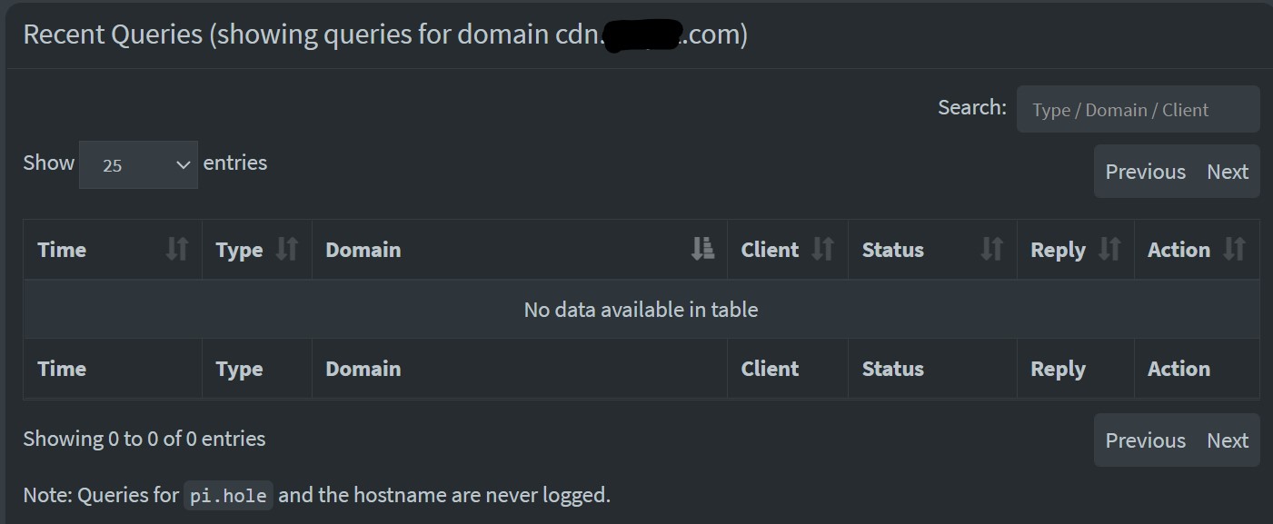

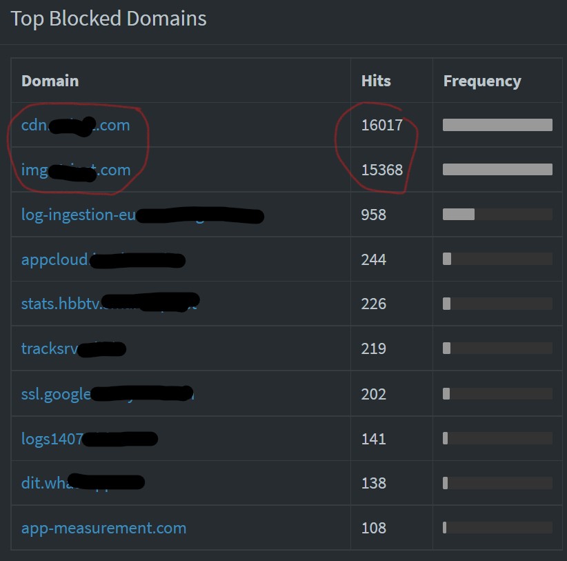

I see two domains leading my toplist with 10k+ hits, but when I click on them there are 0 database entries.
The "Hits" numbers of the top two entries are there unchanged since some 10+ days. Not sure if this is a known bug, or if I just have to wait longer for the toplists to update.

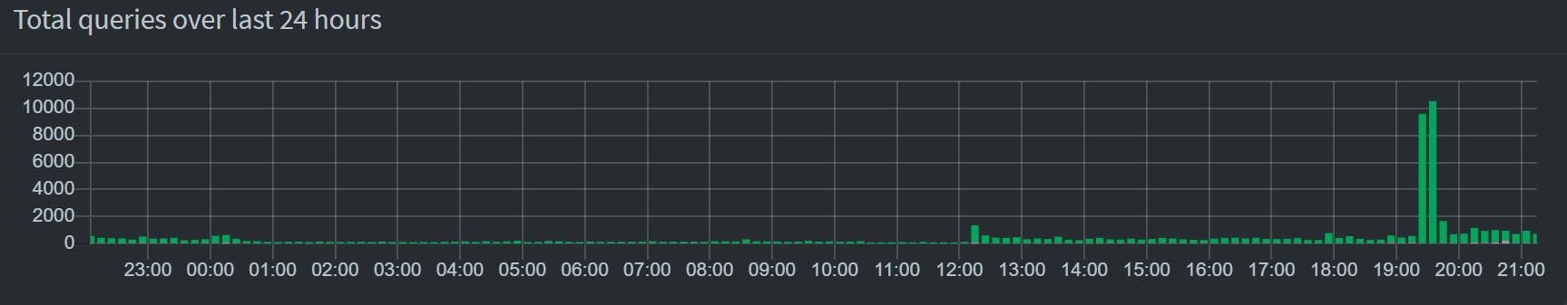

And finally, here are some screens in regard to the initial question with broken toplist entries:

That one is easily explained. My router crashed and until it was rebooted the Pi-Hole was flooded by 30+ devices wondering where the internet went. That results in a query flood/spike as can be seen between 19:00-20:00h
Edit: I think I ran the debug shortly after the router came back online, since it crashed in the middle of typing the original ticket.
Edit 2: Maybe it would make sense to run a 2nd debug log now that the net is operating normally and I have reviewed and cleared the warnings.

So, now that the debug log was analyzed and the API calls etc were explained, I still wonder about my initial post.
Those two toplist leading entries still show up, but when you click on them it still shows no data in the corresponding tables.
From my understanding, the toplist just sums up the total count of a given domains blocked entries table, so there should be actual 16017 and 15368 entries in the details table, not 0.
Are there possible Causes/Solutions? The sqlite command to kick those two domains from the table manually would help a lot.

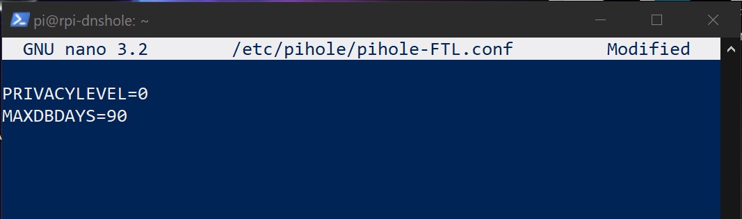

Regarding the long-term database age limit I found something in the manual at Configuration - Pi-hole documentation
Just need a quick confirmation if I read correctly and this config file will limit my long-term database to 90 days (and thereby deleting everything in long-term database older than 90 days):
Is it required to restart FTL or the device to apply the new config settings?

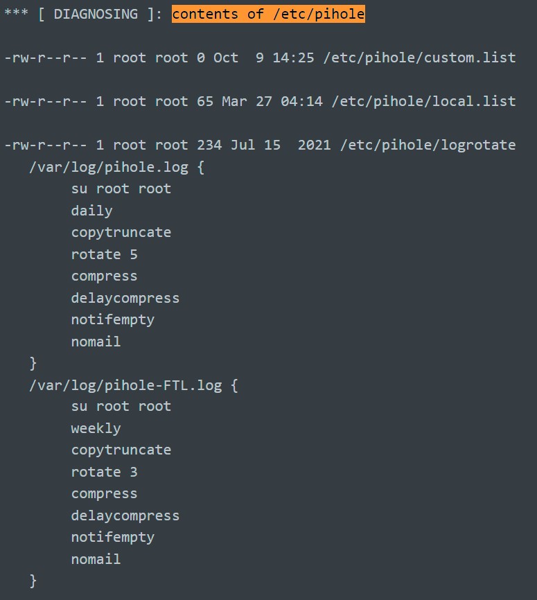

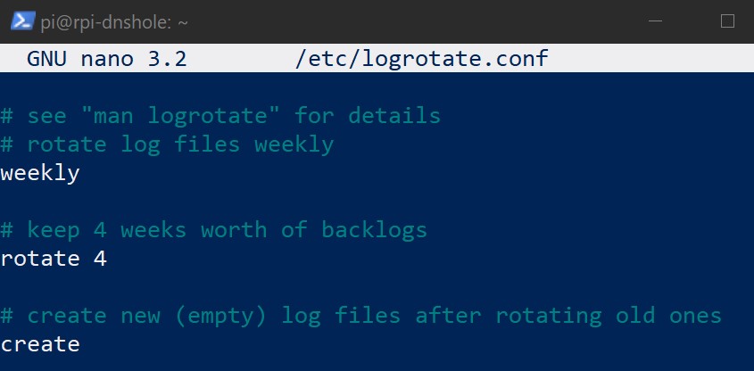

I assume, the log files referenced there are pihole.log and/or pihole-FTL.log
Are those two files size and/or age limited by Debian's system default logrotate settings, so they won't grow endlessly? I found the following settings on the system, just need confirmation that it handles also the two pihole log files:
As the documentation mentions, options in pihole-FTL.conf are read by FTLDNS on startup, so yes, you have to restart Pi-hole, e.g. by pihole restartdns.

No, they are not.
They are controlled and limited by Pi-hole's own logrotate configuration (see your debug log's [DIAGNOSING]: contents of /etc/pihole section).
Do those domains still appear at the top of those lists?
Do they also show up for the following command, run from your Pi-hole host machine?
echo ">top-ads >quit" | nc localhost 4711
What does a grep for those domains in pihole.log* return?
I added MAXDBDAYS=90 and used pihole restartdns. The mentioned domains finally disappeared from the toplists. I let PiHole compute the toplists for the last 3 months, ever there they don't appear anymore.
When I did echo ">top-ads >quit" | nc localhost 4711 before restarting the DNS, it still showed the domains leading the list in the commands output.
However, domains are gone from toplist, the original issue is fixed for me. Thanks for the great support :slight_smile:
This looks to like proper rotation to me. One log daily, keep 5, the other 1 weekly, keep 3.
