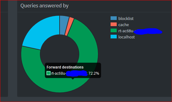

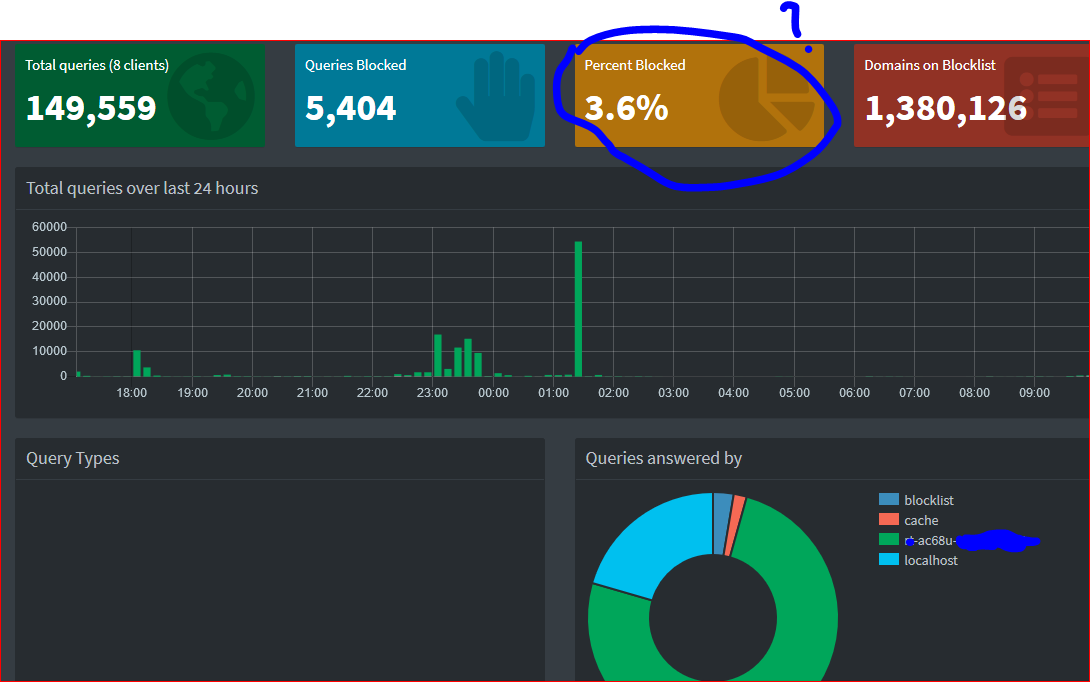

I had to re-input various settings of course... I noticed on my Pi-hole dashboard, the colors and the block % is waaaaay lower. I had about a 30% block of queries, not any more. And I don't know what's going on sadly... if anyone can be detective for me?
the "Forward destinations" is 72.2%... that's my router. what does that mean, my router is 'answering' 72.2% of queries stemming from my devices on my network connected to my router?

The block rate isn't any kind of measure for judging Pi-hole's operation.
It is expected to fluctuate, depending on your network's activity.
Spend a whole day just here in the forums, and block rate while be close to zero.
And you specifically wouldn't want it to be at 100%, as that would mean you can't browse any site at all (if that's what you want, you may just pull the WAN cable from your router).

Check your first picture, there are around 60k !! Request and they are all "ok" and not blocked. Rest of the diagram has only small values... Thats why you "only" got 3.6% blocked. Wait 24h and check again

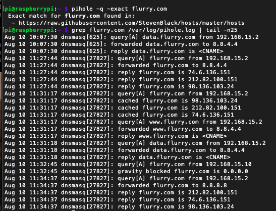

The second went to Pi-hole, and the answer is not what we expect, as this domain should be blocked. So, let's figure out why it isn't being blocked. From the Pi terminal, what are the full outputs of these commands:
pihole -q -exact flurry.com
grep flurry.com /var/log/pihole.log | tail -n25
Here it is , thank you very much for taking this
Screenshot 2020-08-10 at 12.20.36
Sorry for the image but as I am newbie the forum doesn't let me include more than 5 links
I bumped you up a level. You can also copy/paste the output text directly into a reply, and format that text block as "pre-formatted text" using the </> icon on the reply window.
Thank you for the bump and the tip... Here they go
pi@raspberrypi:~ $ pihole -q -exact flurry.com
 Exact match for flurry.com found in:
  - https://raw.githubusercontent.com/StevenBlack/hosts/master/hosts
pi@raspberrypi:~ $ grep flurry.com /var/log/pihole.log | tail -n25
Aug 10 10:07:30 dnsmasq[625]: query[A] data.flurry.com from 192.168.15.2
Aug 10 10:07:30 dnsmasq[625]: forwarded data.flurry.com to 8.8.4.4
Aug 10 10:07:30 dnsmasq[625]: reply data.flurry.com is <CNAME>
Aug 10 11:27:44 dnsmasq[27827]: query[A] flurry.com from 192.168.15.2
Aug 10 11:27:44 dnsmasq[27827]: forwarded flurry.com to 8.8.4.4
Aug 10 11:27:44 dnsmasq[27827]: reply flurry.com is 74.6.136.151
Aug 10 11:27:44 dnsmasq[27827]: reply flurry.com is 212.82.100.151
Aug 10 11:27:44 dnsmasq[27827]: reply flurry.com is 98.136.103.24
Aug 10 11:31:17 dnsmasq[27827]: query[A] flurry.com from 192.168.15.2
Aug 10 11:31:17 dnsmasq[27827]: cached flurry.com is 98.136.103.24
Aug 10 11:31:17 dnsmasq[27827]: cached flurry.com is 212.82.100.151
Aug 10 11:31:17 dnsmasq[27827]: cached flurry.com is 74.6.136.151
Aug 10 11:31:17 dnsmasq[27827]: query[A] www.flurry.com from 192.168.15.2
Aug 10 11:31:17 dnsmasq[27827]: forwarded www.flurry.com to 8.8.4.4
Aug 10 11:31:17 dnsmasq[27827]: reply www.flurry.com is <CNAME>
Aug 10 11:31:18 dnsmasq[27827]: query[A] data.flurry.com from 192.168.15.2
Aug 10 11:31:18 dnsmasq[27827]: forwarded data.flurry.com to 8.8.4.4
Aug 10 11:31:18 dnsmasq[27827]: reply data.flurry.com is <CNAME>
Aug 10 11:32:45 dnsmasq[27827]: query[A] flurry.com from 192.168.15.10
Aug 10 11:32:45 dnsmasq[27827]: gravity blocked flurry.com is 0.0.0.0
Aug 10 11:34:37 dnsmasq[27827]: query[A] flurry.com from 192.168.15.2
Aug 10 11:34:37 dnsmasq[27827]: forwarded flurry.com to 8.8.8.8
Aug 10 11:34:37 dnsmasq[27827]: reply flurry.com is 212.82.100.151
Aug 10 11:34:37 dnsmasq[27827]: reply flurry.com is 74.6.136.151
Aug 10 11:34:37 dnsmasq[27827]: reply flurry.com is 98.136.103.24
pi@raspberrypi:~ $

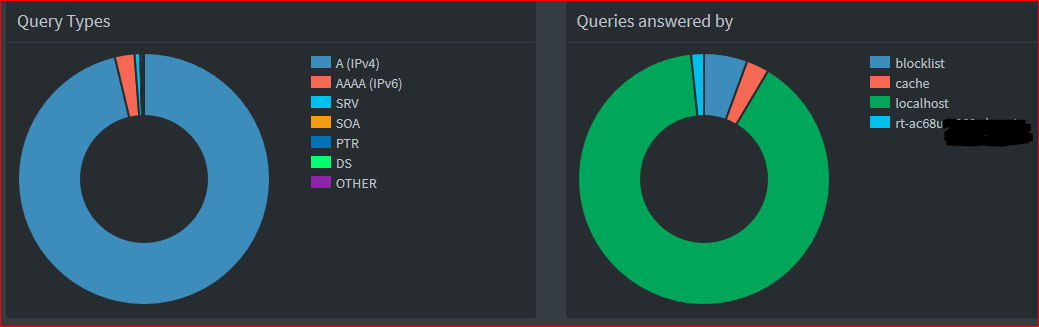

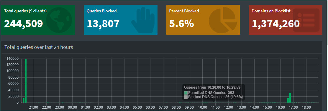

heheheh, oh i most certainly would not want it to be 100%.
i just cant make out how the pie chart looks different and the 24hr query chart is less busy after the only change to my environment was a firmware update to my router necessitating setting it up again.
here's my updated info: screencaps:
the forward destinations for my router rt-ac68u went from 72.2%green to blue 1.7%
the local host is now green and 90.6%
last night local host was the baby blue, looks like 25%
only change i did was fiddle with using a DNS filter hoping to route all dns requests from my lan, to my pihole.
