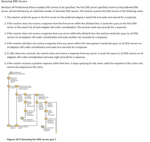

Read this bit I posted yesterday:
This is INCORRECT. Excluding cache scenarios, hosts file, etc., Windows DNS client always hits it's primary DNS server first and if it falls, then tries it's alternative DNS servers.
https://docs.microsoft.com/en-us/previous-versions/windows/it-pro/windows-xp/bb457118(v=technet.10)
The resolver also keeps track of which servers answer queries more quickly, and it might move servers up or down on the list based on how quickly they reply to queries.
https://social.technet.microsoft.com/Forums/Lync/en-US/5b5467b2-dc96-4d93-bd19-ee038ec4155c/dns-queries-failing-when-primary-server-is-being-rebooted?forum=winserverNIS
If the DNS server does not respond, which we call a NULL response (when the DNS is down and can't respond), it will go to subsequent DNS entries in the order entered in the NIC after a time out period
If you dont want to believe me and prefer another forum post over the official MS doc, thats fine with me.

What part exactly of this dont you get:
Windows XP Professional allows multiple DNS servers to be specified. The first DNS server specified, known as the preferred DNS server, can be followed by an unlimited number of alternate DNS servers.
1. The resolver sends the query to the first server on the preferred adapter’s search list and waits one second for a response.
2. If the resolver does not receive a response from the first server within the allotted time, it sends the query to the first DNS server on the search list of each adapter still under consideration. The resolver waits two seconds for a response.
3. If the resolver does not receive a response from any server within this allotted time, the resolver sends the query to all DNS servers on all adapters still under consideration and waits another two seconds for a response.

Google for "Microsoft Smart Multi-Homed Name Resolution"
I had a hard time to find any docs on Windows so decided to manually configure a win7 setup with primary being Pi-hole and secondary my router DNS (with no Pi-hole upstream).
nslookup was persistently hitting the primary DNS but as soon as I browsed to my favorite local news site, ads appeared all over the place that I usually never see when Pi-hole is doing its job.
There are many implementations depending OS, release or app how the resolver operates.
And as you cant be sure what kind of devices are connecting, assuming that always the primary DNS will get all queries is no guaranty
