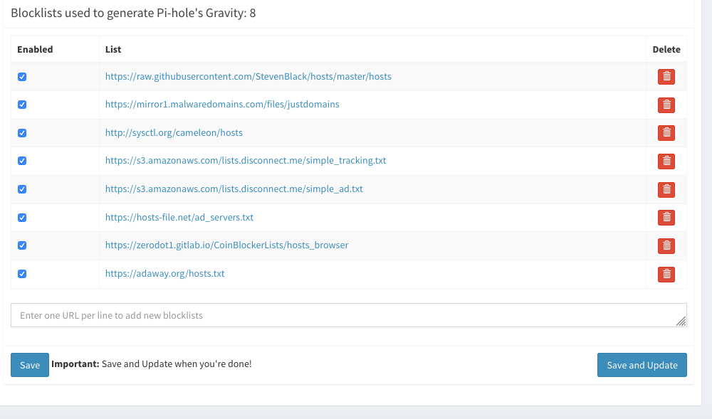

any good blacklists? these are the blacklists I have:
