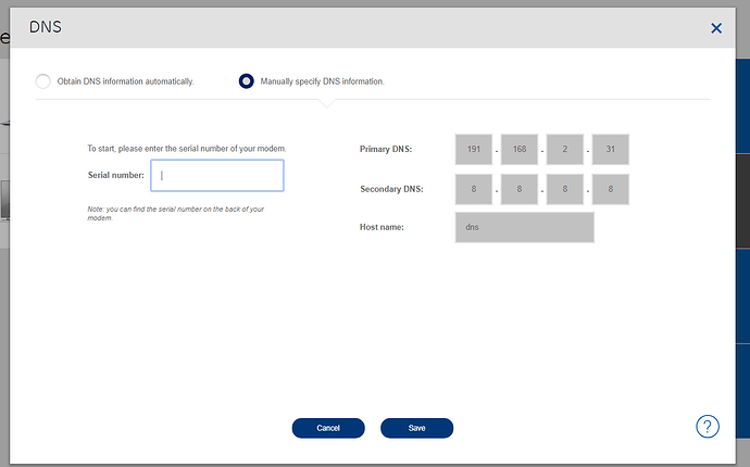

@darcnl I know this is a old post, but for my HomeHub 300 all I have to do is press Change on the Manually specify DNS information page and enter the routers serial number and that unlocks the settings.
I know this is an even older post now, but does that work for you? For me it doesn't accept local ips.
Same problem here even if I enter the local IP of my pihole it still uses the default Bell DNS IP as secondary and therefore is making my pihole useless because it prioritizes the fastest one I believe.
I contacted bell support, they said local IPs are only supported on business plan routers.

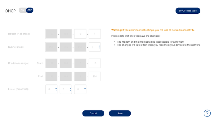

Maybe its too to reply but I was having same problem and I have fixed it by disabling DHCP from my router and enabling DHCP from Pi-hole.
Thanks for posting this. I have recently upgraded and have the same modem / router as you. I was scratching my head as to where the settings were. I guess my pi-hole will become my dhcp server soon.
I am trying to setup pi hole with my bell hub 3000 modem. When I disable DHCP on the modem and enable it on the pi-hole, 2 things happen:-
  1. I can't connect to internet from my pi.
  2. When I access internet from any other device, ads still show. The pi-hole settings are as below
    Is there some other settings that I need to do?
I am having the same issue. When I disable DHCP on the modem and enable it on the pi-hole, the ads are still showing. My settings are the same as your screenshots. Were you able to get it working?
Unfortunately, not. Let me know if you were able to get it working
You will have to wait for the DHCP lease to renew on each device. The default for the Bell Router is 3 days. So It will take up to 3 days for a device to make a request for a new IP address, then the piHole will send the new DNS info along with the IP info.
You can skip the wait by manually renewing the IP lease on each device.
It is working now after manually renewing the lease on each device! Thank you

I have a raspberry pi zero so it is connected by wifi. All I did was enable DHCP in the Pi-hole settings, type in the Bell modem's IP address in the Pi-settings under Router (gateway) address, and then turn off DHCP in the bell modem settings. Just like in your screenshots.
You need to restart the Bell modem for it to take effect. Then you need to renew the lease on all the devices connected to your network.
