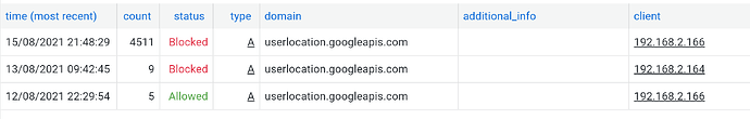

during the end stage of the gravity run, following message(s) may appear:
[2021-07-10 09:13:00.567 7474M] domain_in_list("userlocation.googleapis.com", 0x73715f80, gravity): Database is busy, assuming domain is NOT on list
request: option to allow (current default) or block the requests (preferred), this to, for example, prevent communicating the device location to google.
This is tricky because it needs some code to be rewritten. Assuming something is not blocked is easy. However, if we (temporarily) assume it is blocked, then this knowledge will be added to the DNS cache. We need to build a method to allow blocking without entering the DNS cache for this to work as expected.
I wonder if we should do something altogether different in this case: Refusing the query altogether. This is neither a positive nor a negative answer and should retrigger a lookup from the client (hopefully with some added delay, but this is something we cannot control).
What do you think?
Fine by me, aslong as the client isn't able to provide the information (example userlocation) to google (again, example).
However, since you have no idea how many retries are going to be issued by the client, you should watch out this doesn't trigger rate limiting...

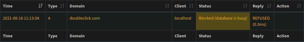

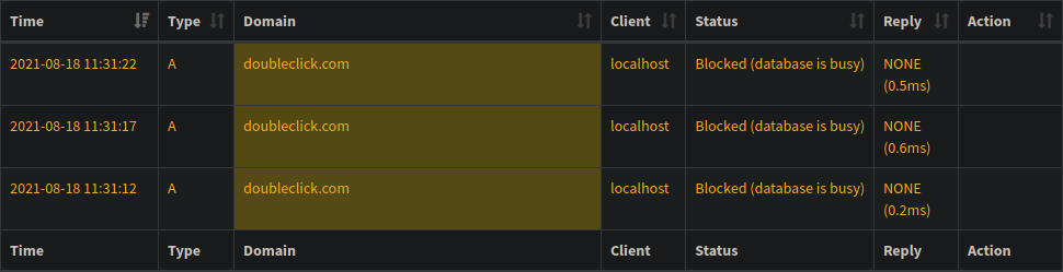

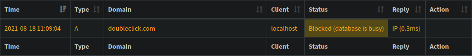

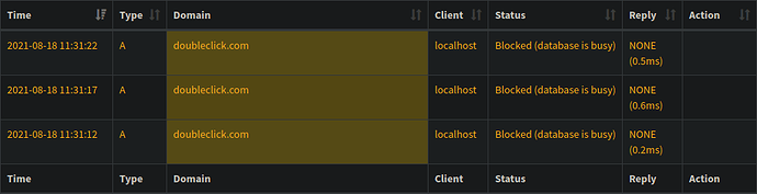

You will not see anything special about ALLOW (as before). However, you will see details in the Query Log for the other three options. They are shown in orange (in contrast to the others in red/green/gray) to highlight that something out of the ordinary has happened here.
ALLOW
BLOCK
REFUSE
DROP
The screenshot above reveals a retry timeout of five seconds for the DROP method which is why it is still my favorite here.

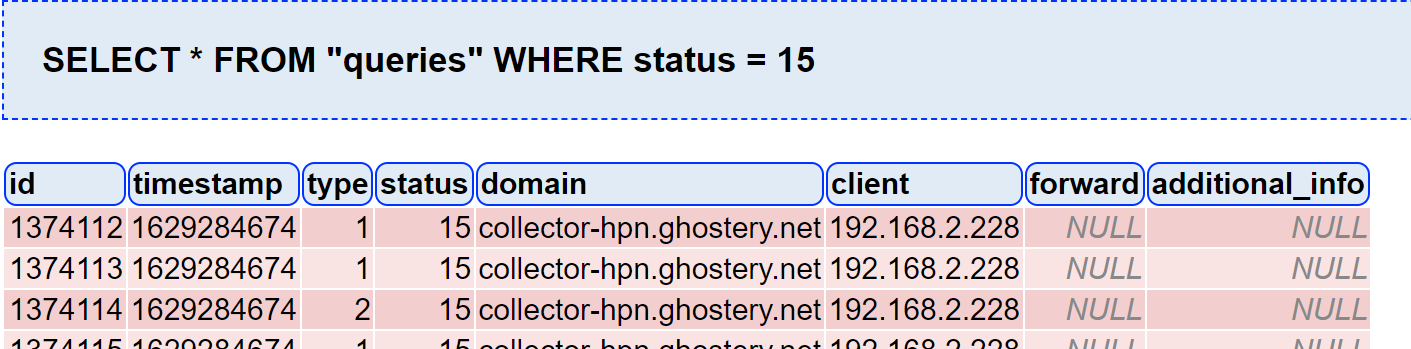

something appears to be wrong, the web interface shows
the database shows:
the log also shows this, multiple identical queries at exactly the same time.
This very much looks like it hasn't worked. FTL should have logged
REPLY_WHEN_BUSY: Drop queries when the database is busy
during startup if it has read it correctly.

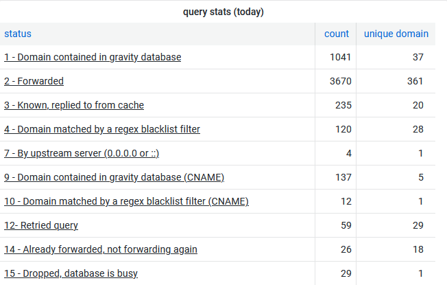

I assume the new status type 15 means dropped.
I switched back to dev, than to the new branches (tweak/blocking_while_busy)
With dev, I see:
[2021-08-18 12:55:17.212 11202M] domain_in_list("incoming.telemetry.mozilla.org", 0x73710670, whitelist): Database is busy, assuming domain is NOT on list
[2021-08-18 12:55:19.107 11202M] domain_in_list("inbox.google.com", 0x73713eb0, whitelist): Database is busy, assuming domain is NOT on list
[2021-08-18 12:56:21.068 11202M] domain_in_list("collector-hpn.ghostery.net", 0x1a198b8, blacklist): Database is busy, assuming domain is NOT on list
[2021-08-18 12:56:21.073 11202M] domain_in_list("collector-hpn.privacy.ghostery.net", 0x73713550, whitelist): Database is busy, assuming domain is NOT on list

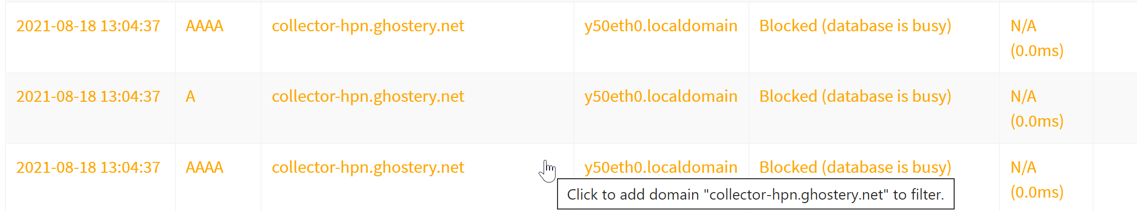

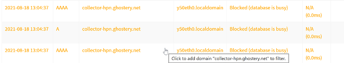

With tweak/blocking_while_busy, I see (29 times the 3 messages)
[2021-08-18 13:04:36.644 14886M] Gravity database is busy (whitelist)
[2021-08-18 13:04:36.645 14886M] Gravity database is busy (blacklist)
[2021-08-18 13:04:34.628 14886M] Gravity database is busy (gravity)

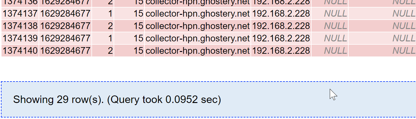

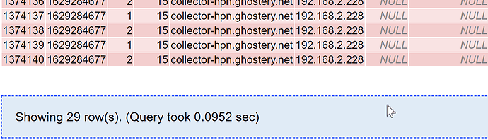

and I find 29 status 15 entries:
the web interface shows:
so at least, drop appears to work.

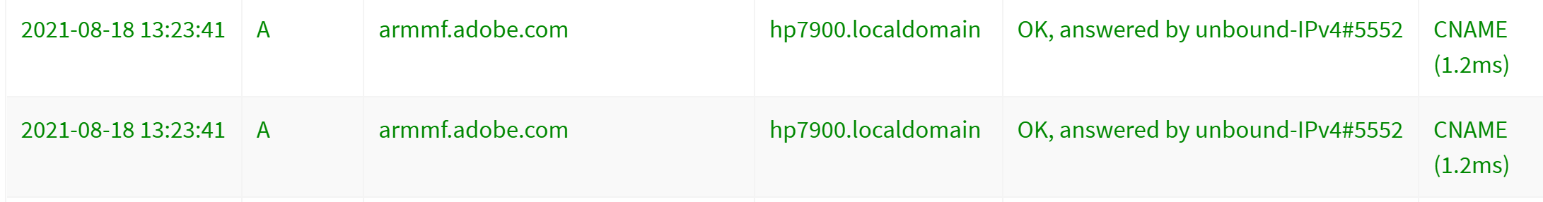

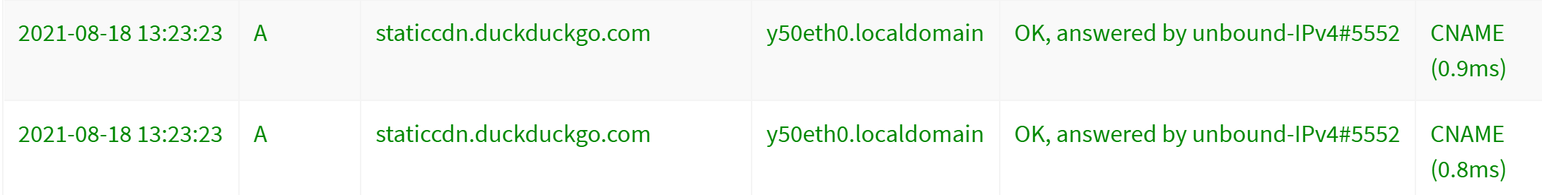

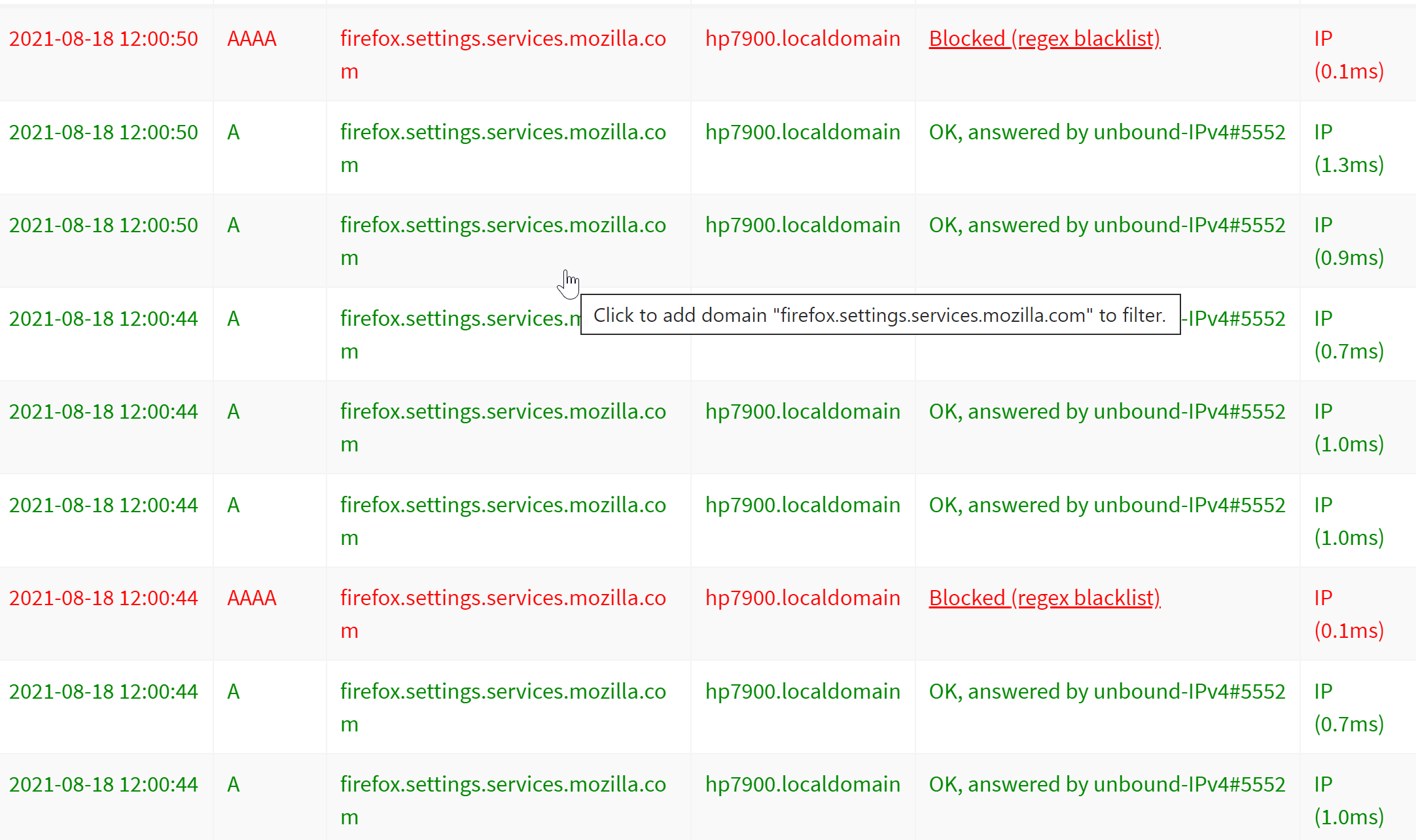

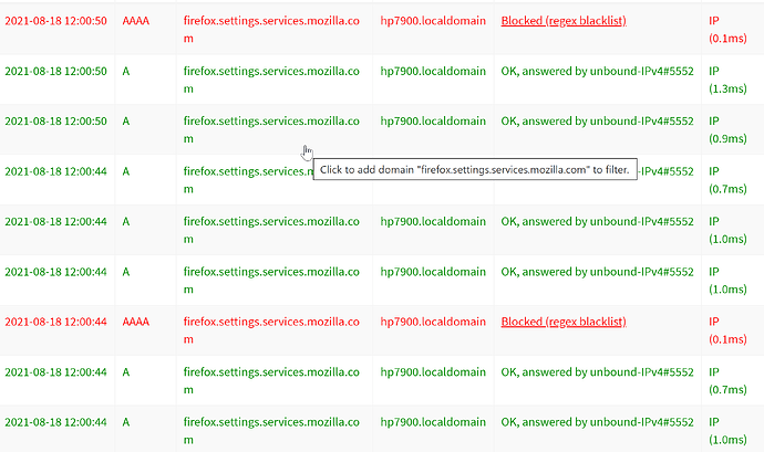

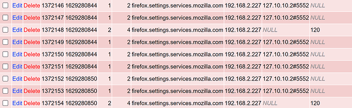

I do however not understand where the duplicates suddenly come from, such as:
identical queries, identical time, both forwarded to unbound

Next I checked allow.zip and there we see some duplicates after the gravity run (the last three):
[2021-08-18 15:25:11.197 20626M] **** new UDP IPv4 query[A] query "ssl.google-analytics.com" from -:<client 2>#53530
[2021-08-18 15:25:36.200 20626M] **** new UDP IPv4 query[A] query "livetileedge.dsx.mp.microsoft.com" from -:<client 1>#57229
[2021-08-18 15:25:46.078 20626M] **** new UDP IPv4 query[A] query "userlocation.googleapis.com" from -:<client 2>#59625
[2021-08-18 15:25:51.898 20626M] **** new UDP IPv4 query[A] query "firefox.settings.services.mozilla.com" from -:<client 1>#57790
[2021-08-18 15:25:51.909 20626M] **** new UDP IPv4 query[A] query "firefox.settings.services.mozilla.com" from -:<client 1>#65422
[2021-08-18 15:25:51.918 20626M] **** new UDP IPv4 query[A] query "firefox.settings.services.mozilla.com" from -:<client 1>#65158
However, they are all correct. I left the port from which they sent the query at the end of the copied line - you can see that they are all different, i.e., those are independent queries from the clients themselves. As to why they are doing this ... I don't know. They arrived with about 10 milliseconds distance between them and, at first, I was confused why they aren't cached but you may have disabled caching and then everything behaves just as expected.
Similarly for block.zip where the query to getgreenshot.org was duplicated, however, these also were doubled queries from the clients themselves so nothing looks like a Pi-hole induced issue.

Everything still looks fine - except the very fast retries when we want to drop. The duplicate queries are here client-side also.
I pushed another update (FTL version should be vDev-2edd512) that should prevent the almost immediate replies (few ms delay) you've seen in DROP mode for ssl.google-analytics.com above.
edit 6c6188f1 would be okay as well. I fixed a small glitch with TCP queries not always being dropped.
