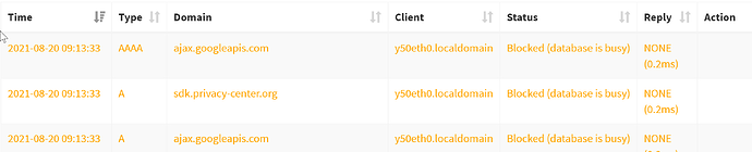

I've run pihole -g like twenty times now, the text 'gravity database is not available' doesn't appear in the log file anymore...

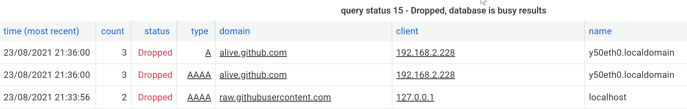

after running the update, I checked for status type 15, and yes, their back 69 entries after the new FTL became active, 15 unique domains

In the pihole-FTL log, I found (41 times):
[2021-08-20 09:09:57.387 9764M] Gravity database is busy (whitelist)
[2021-08-20 09:09:57.388 9764M] Gravity database is busy (blacklist)
and (90 matches)
[2021-08-20 09:11:40.007 9764M] ERROR: Gravity database not available
[2021-08-20 09:11:40.007 9764M] get_client_groupids("192.168.2.228") - SQL error step: database is locked
I assume this is normal, some FTL thread is still trying to acces the database.
I'm NOT sure how you determine what you consider to be a client initiated resubmitted query, and thus a normal situation. Could you please explain what to look for, to identify duplicates (that shouldn't happen) and resubmitted (that is normal)?

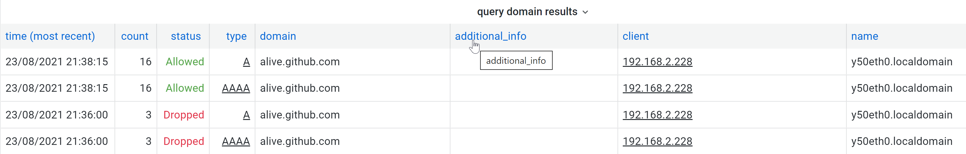

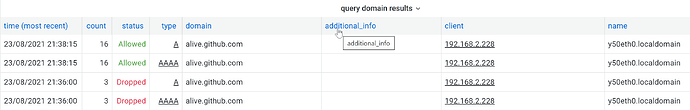

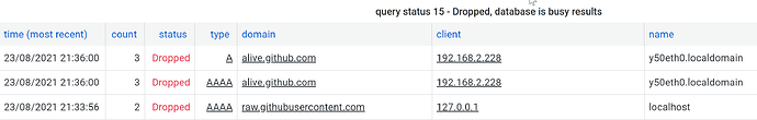

Just to let you know, the results of this, after updating to
Pi-hole version is development v5.3.1-100-g98867d8d (Latest: v5.3.1)
AdminLTE version is release/v5.6 v5.5.1-65-g224f906 (Latest: v5.5.1)
FTL version is release/v5.9 vDev-9a53df6 (Latest: v5.8.1)
Thanks, this looks promising. We should make DROP the new default in a future Pi-hole release.
Word of warning (again), if you're going to make DROP the default.
Correct me if I'm wrong
  • on new deployed (from scratch) pihole, the pi will not be a client of pihole-FTL, all queries will be resolved by whatever was configured as the resolver during installation
  • on an existing pihole, that has been upgrade from pihole v4 or earlier, the pi will be a client of pihole-FTL, all queries will be submitted to pihole-FTL.
This implies as you can see in my screenshots (I've changed the behaviour to pre-v5, e.g. my pi is a pihole-FTL client), some queries from 127.0.0.1, during pihole -up / pihole -g are dropped.
Because the pi (127.0.0.1) almost immediatly retries, there isn't a detectable problem, but it does happen (DROP on the pi). I don't know how docker, a VM, or a slower pi (ZERO) will behave. I'm running things on a 3B.
