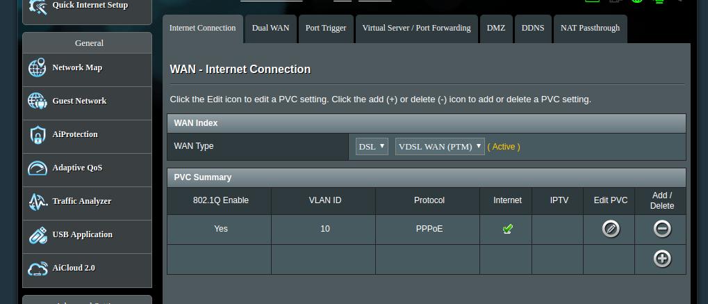

From screenshot, it appears you dont have settings to configure upstream WAN DNS servers.
These DNS servers are probably supplied via the DSL connection.

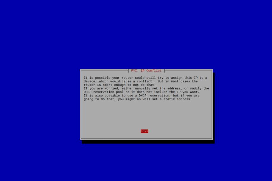

Hmmmm! when it ran through the reconfigure, it still showed 10.1.1.240 (even though I had rebooted!)....I must be doing something wrong and causing cascading problems
in the reconfigure..I can't believe it can be this complex, so I must be misunderstanding your instructions through lack of experience/knowledge.....sorry!......and now it has hung before it completed!!
