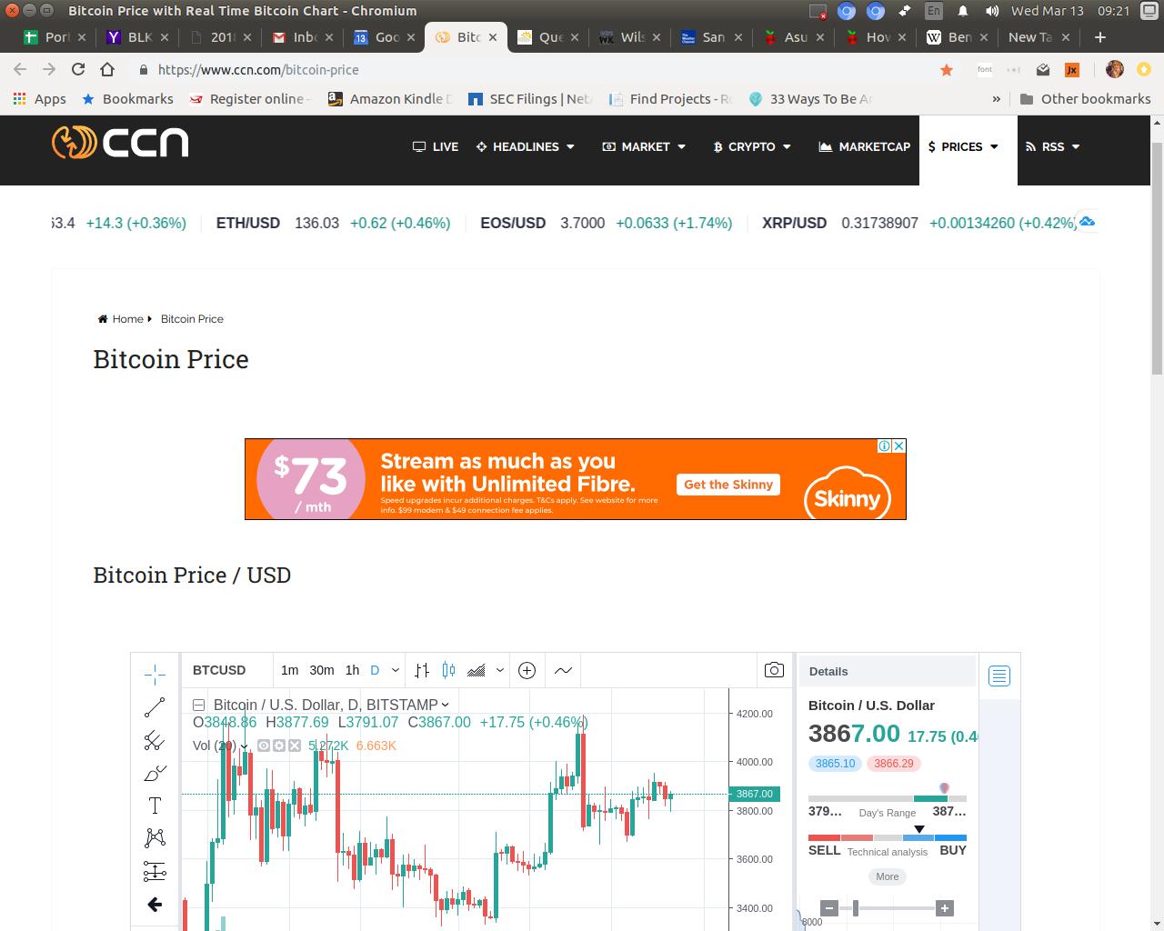

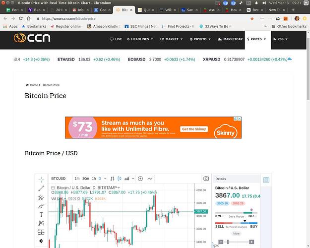

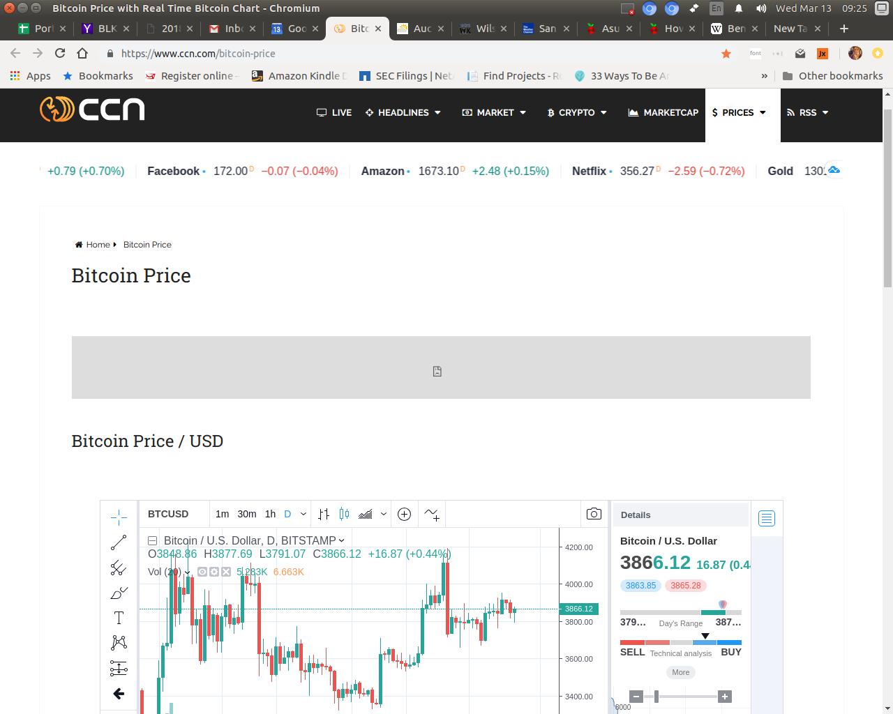

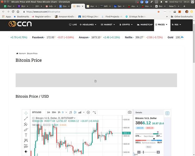

The above were my commands. Before my commands, the webpage (Bitcoin.jpg) after the commands the webpage (BitcoinAfter.jpg). Seems very weird?!!
...advert gone. Maybe it has to do with this dual DNS problem?

Sorry, I did not make myself very clear. The bright orange advert "Stream as much as you like...." was showing in the Bitcoin page before I ran the nslookup scripts. After I ran the scripts it was no longer showing. I have not yet changed the DHCP to the Pi. So, surmising, that the difference in the webpages (the orange advert) is part of the dual DHCP problem? No?
Yes this is most likely the dual DNS problem.
Two DNS servers pushed from the Asus router to the clients via DHCP.

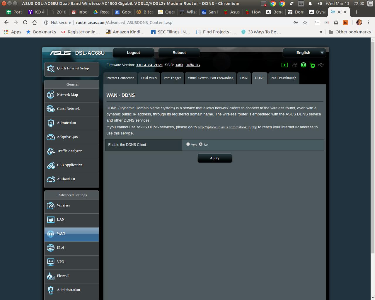

Did you edit this WAN DNS setting on the router ?
What was in it before you started tinkering with Pi-hole ?
Below my settings with 192.168.1.1 being my upstream ISP modem and 62.58.48.30 is one of the DNS servers from my ISP:

Thats the wrong tab on the screenshot, you should look under the "Internet Connection" tab.
