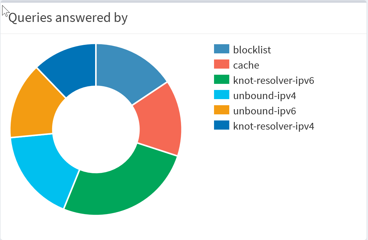

got it up and running yesterday, but got distracted by this problem. I read this reply from you (I think I’ll setup a new Pi and see what I get), so you will be running into this too...
Looks impressive! I might try something like this some day... :slight_smile: Would you mind posting your Unbound config?

As you can see, I no longer use pihole-FTL for DNSSEC (to many problems), both unbound and knot-resolver are capable of doing this.
