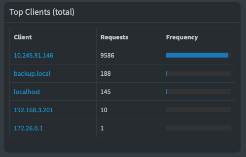

Setup: I am running Pi-hole as part of a IOTStack (using docker-compose). In that stack I have Pi-hole and ZeroTier running, among other things. My router has its DNS address pointed to the device running Pi-hole.
My local network IP range is 192.168.3.*. The ZeroTier IP range is 10.144.*.* (if that matters).
In the Pi-hole clients list I can see mainly one client that seems to pass all the traffic. I do not recognize it and I cannot understand where it gets that IP: 10.245.91.146.

I understand that 172.17.0.1 belongs to the Docker process, but I do not understand where 10.245.91.146 comes from...
Looking at the Pi-hole logs almost all traffic is coming from it, all the local requests from all the devices connected to the network.
The issue seems to be similar to this one, but I have all connections coming from yet another IP.
I'd like to understand what device it is/where does this IP come from. Ideally, I'd like to have the local devices show their true IPs so I can categorize them.
It feels like I have some proxy in between the devices and Pi-hole, maybe ZeroTier is messing with the network? I do not have the skills to investigate further.
Would anyone have an idea on how to debunk this situation or perhaps make it so the device IPs show up instead of this mystery one?

A couple of extra things to try:
  1. The command dig -x 10.245.91.146 might reveal a hostname on your network
  2. Click on the IP in the Top Clients list and this will show you its queries in the Query Log. Perhaps some of those queries will reveal its purpose and help identify it
chrislph: Thank you.
  1. Tried, unfortunately it did not show the hostname.
  2. Looking at the queries it looks like pretty much everything, from all devices, goes through this client.
