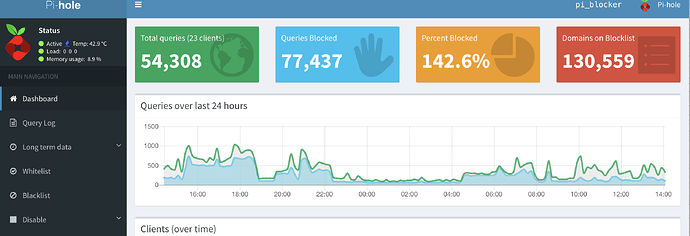

So one more interesting thing I'm seeing.. It seems that my total blocked stats are way off. It's reporting that I'm blocking more than the total number of queries made.
Any idea how this happens?
That is a bug that will be fixed in the next release.
Ok great, thank you. You could just call it a feature though... Pi-Hole is SO good we block 180% of your traffic! :wink:
