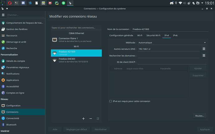

That's for the command and I think I will just specify the sole DNS (thinking on how to do that)
that's a proper response.
On your network card properties on the mac via settings :wink:
Changed my DNS from 1.1.1.1 to 192.168.1.2
Still adblocking not working. :disappointed_relieved:
If you are connected to ethernet, you need to set it up there too as Ethernet is preferred over WiFi when both connected.
We know Pi-hole is working because if from your CLI you execute the query, via Pi-hole, it blocks. This issue is related to your local settings and how they are routed/processed.
I never been connected to Ethernet excepted that one time when I messed up with Pi hole config and I selected the wrong interface.
