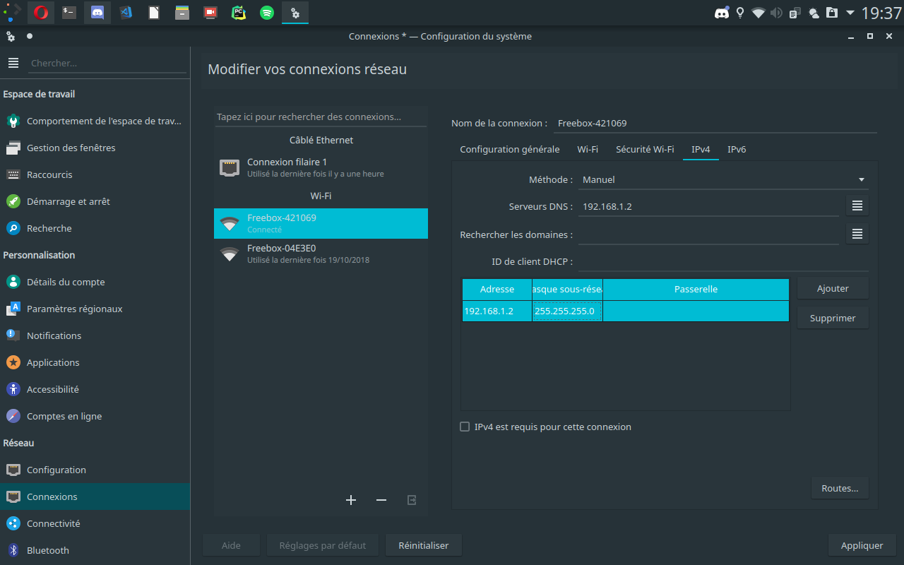

Set the connection method then to manual.
The DNS setting you share via the screenshot states "Alternative DNS servers" as in it pulls the setting from the DHCP server and sets this as a secondary or alternative DNS.
Set your IPV4 network to manual and use the same IP as DNS1.
So I need to modify it in the router's settings?
No, only on your mac. Your IPV4 settings, set them to manual and use the 192.168.1.2 as the DNS.
Like that ?
Yes. Try it now.
