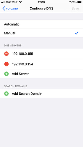

Here is an example of an iPhone manually configured to use two Pi-Holes:

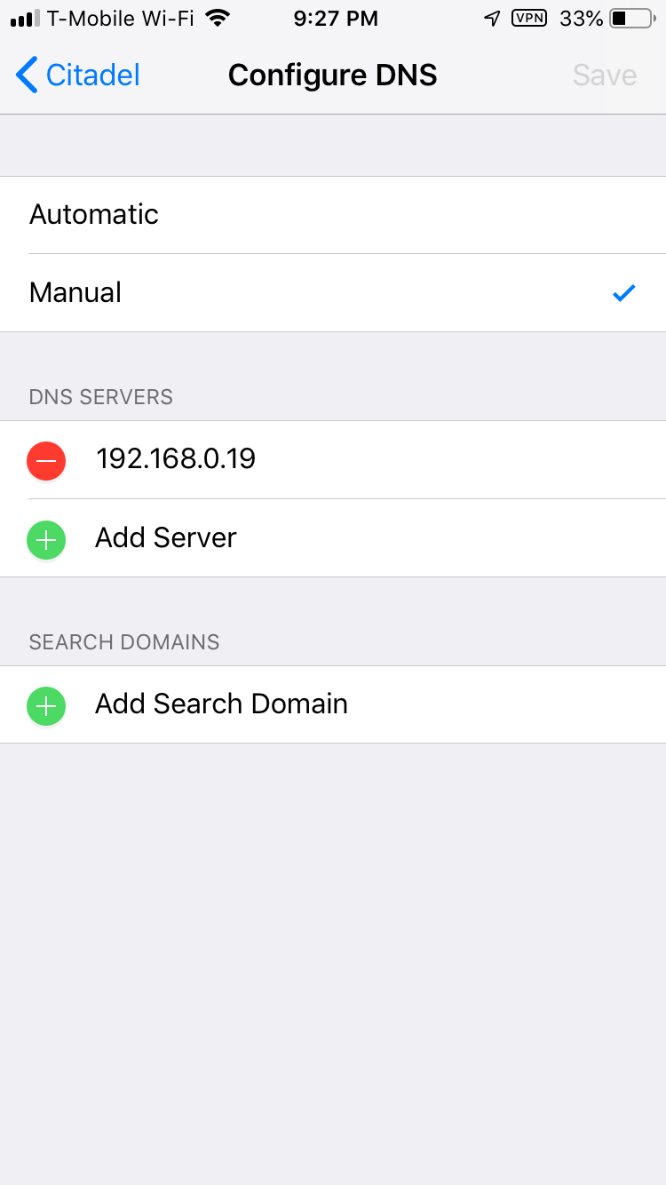

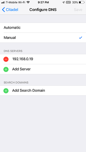

This is a strong indication that the iPhone is using a different DNS than Pi-Hole. On the phone, look at settings > Wifi > click the circled "i" next to the active WiFi name > DNS > configure DNS. This screen should show you the DNS servers in use by that iPhone. The only IP listed should be the IP of Pi-Hole.
What do you see there?
It is set to the pi hole dns ip
