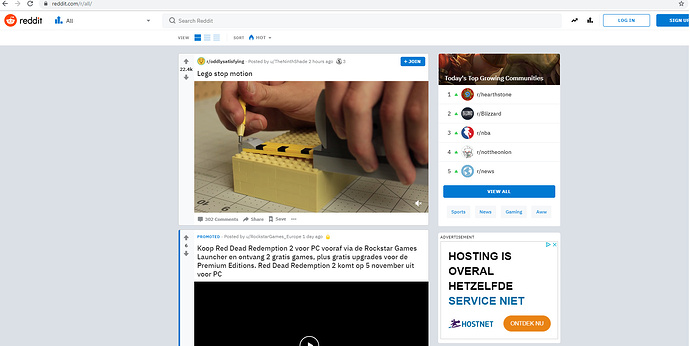

It does not block ads, see this example from reddit.com:

None of these IPv6 addresses are your Pi-Hole. These are likely being provided by the ISP via your router. If you disable IPv6 on the router and clients, this typically resolves the problem. Very few users need IPv6 and an IPv6 DNS request can be resolved by IPv4.
