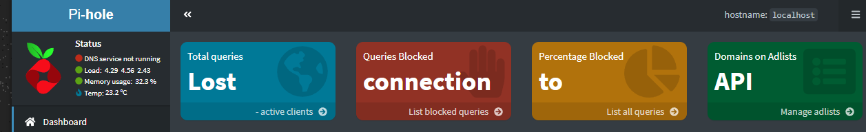

I'm working on figuring out how to get Pi-Hole up and running, and I've gotten to the point where pihole is running on the phone and I can sort of hit the admin page. However, it does not appear to actually be running, even though it says it's enabled on command line. Clicking on "Enable Blocking" causes it to go green, but as soon as I change a page it goes back to red. Ads are still showing, although curiously when I do pihole -c it appears to be blocking something. I'm thinking it might be a configuration thing, but I've tried different settings when reconfiguring and there's still errors.
If it helps, pi.hole/admin does not work and times out while <ip>/admin does.

Your screenshot shows the web page is not able to connect to FTL.
This could mean FTL is offline, or the connection using port 4711 is not possible, or it could also mean PHP session expired and you just need to login again.

On the browser it still shows "Lost Connection to API", and the "Enable Blocking" button does not persist a change, so I don't think it's connecting.
