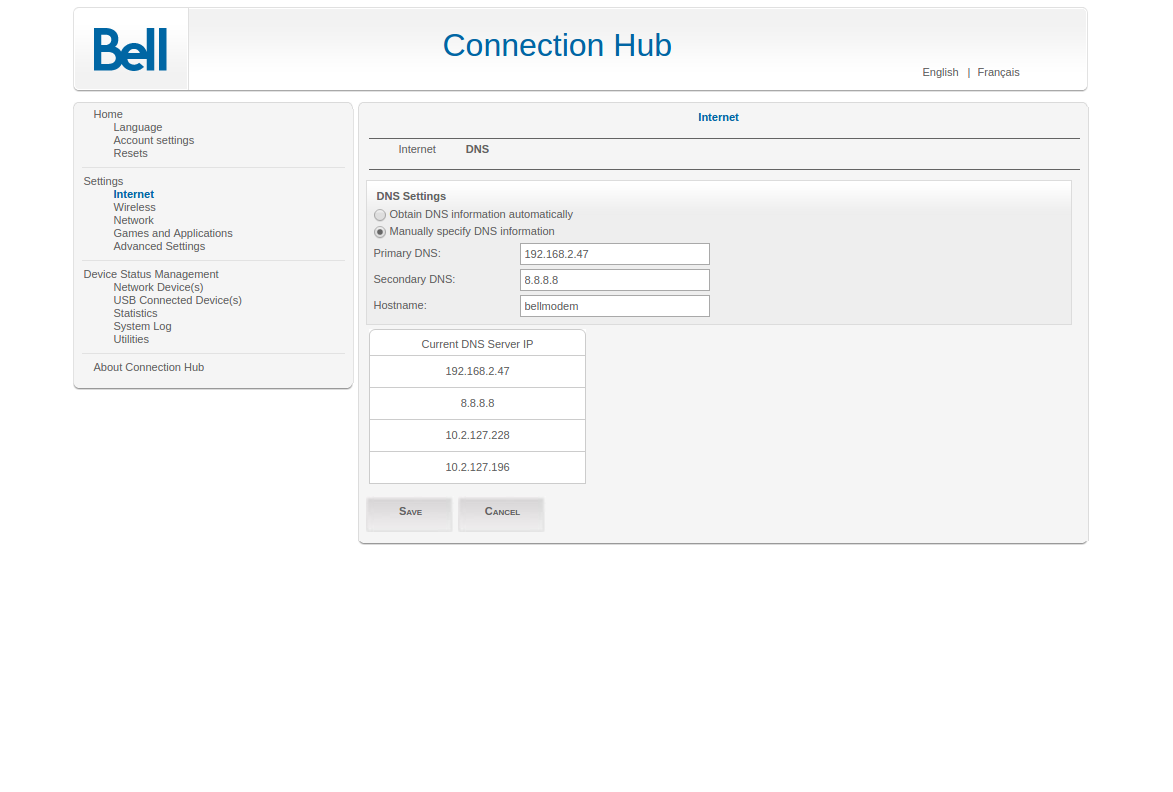

I only seem to have one place on my router (it is a Bell Sagemcom 2864) that I can manually set the DNS. This is the screenshot.

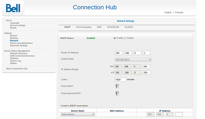

The DHCP page on the router looks like this, and doesn't have a separate spot to set a DNS here.
It looks like that router doesn't let you set a DNS server for your DHCP clients.
The best alternative to achieve the functionality you want, is to use Pi-hole's built in DHCP server. It can be activated from the Settings page. If you do this, make sure you disable DHCP on your router.

I would love to do this. However, the Bell router is serving both my internet and my IPTV settings. When I've looked in the past to try set up my own separate DHCP server, other forums have indicated that it may screw up my IPTV (I have three different boxes throughout the house) and disable by TV viewing abilities, which would not please the other members of my network (a.k.a The Family!).
