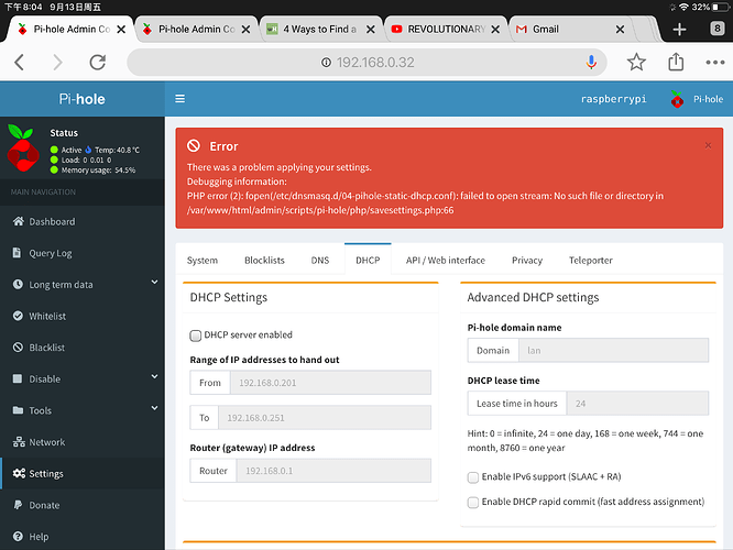

Adding a host name error
No error message
Actual Behavior
https://tricorder.pi-hole.net/qp1e5qsfhn
I'm not clear on what you were trying to do. What were you trying to add and where? If you were trying to add information at the bottom of that screen using the "+" box, it won't work because Pi-Hole is not your DHCP server.
