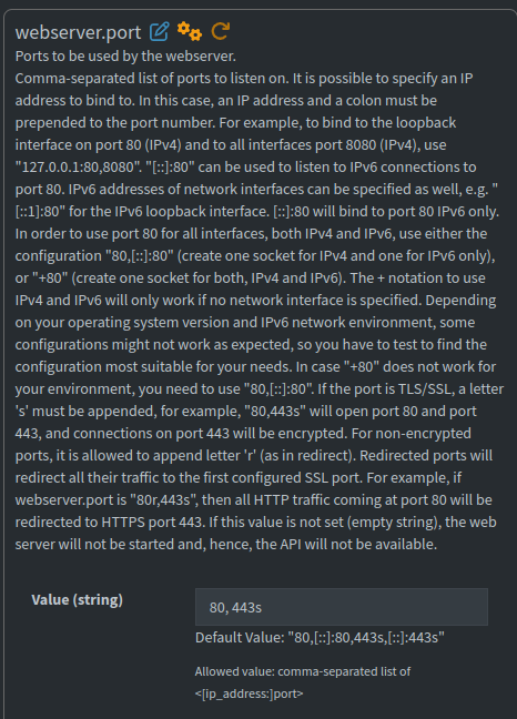

Pi-hole v6 will allow to change the GUI port from the web interface itself.
If you don't have Web UI installed or it is inaccessible, you can find webserver.port configuration in /etc/pihole/pihole.toml
was looking all over and this was the only thing that worked, thank you
If you want to change ports via command line, use:
sudo pihole-FTL --config webserver.port '80o,443os,[::]:80o,[::]:443os'
Note:
add the o flag to make the port optional (the server will start even if this port is in use) ;
add the s flag to make the port secure (used for https) ;
add the r flag to force redirect to secure port ('80r,443s' will redirect port 80 to 443) ;
[::]: are used to configure IPv6 ports. This is optional;
You can add an IP to bind the port to that IP ('192.168.0.100:80' will bind port 80 only for this IP) .
