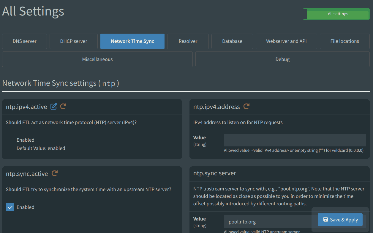

Note that upcoming Pi-hole v6 will embed both a simple NTP client as well as an NTP server, where you could configure relevant settings via Pi-hole's UI:
