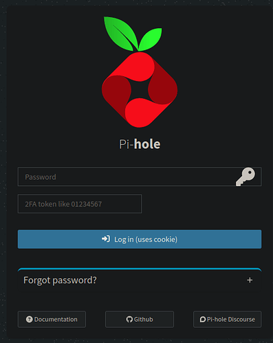

The layout can surely be improved but here is a screenshot from the login page of the v6.0 draft (branch devel-v6). The second input field is only shown when TOTP is enabled on this Pi-hole.

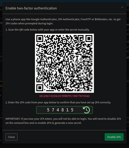

Hi, sorry for noob here, but how can I enable 2FA I see it in the documentation but not on the front end? do I need to grab the development version still? I am using Core v6.0.6FTL v6.1Web interface v6.1
  • Go to Settings > Web Interface - API page;
  • Switch from Basic to Expert mode;
  • Find the Advanced Settings box and click on the green Enable 2FA button;
  • a pop-up will open. Follow the instructions on the screen and confirm clicking on the other Enable 2FA button.
Thanks :slight_smile:
I must be blind looked there like 4 times lmao.
