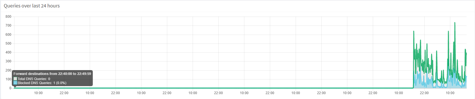

Should show last 24h queries
Shows 4x 24H

It may be that at some point your Pi-hole device had the time set in the future, or your browser thinks it's in the past. We only put a minimum bound of 24 hours on what the graph displays.
I had this same problem last week with FTLDNS. Pi time was correct and that Pi is on a UPS, so I don't think it was a power loss problem either. To clear it, I disabled logging, flushed cache and re-enable logging. I didn't find the cause, but this cleared the problem.
