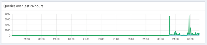

24 hour graph hour axis is not correct
Running the FTL dev version and expecting to see hour increments on the 24 hour graph.
Hour axis only shows 21:00 and 9:00 as per the screenshot.

See 24H Query shows 4x 24H timeframe
I read that before posting and think that the proposed issue/resolution doesn't apply. I set my pi up a few weeks ago, and I tested accessing the interface from my Mac and iPhone with same results. So i know it is not the browser clock and I know it can't be the Pi clock.
The pi was configured for the EDT TZ when I set it up weeks ago and my iPhone and Mac get time via NTP.
