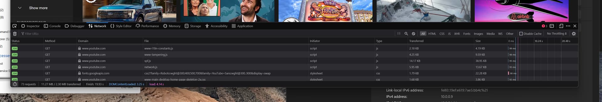

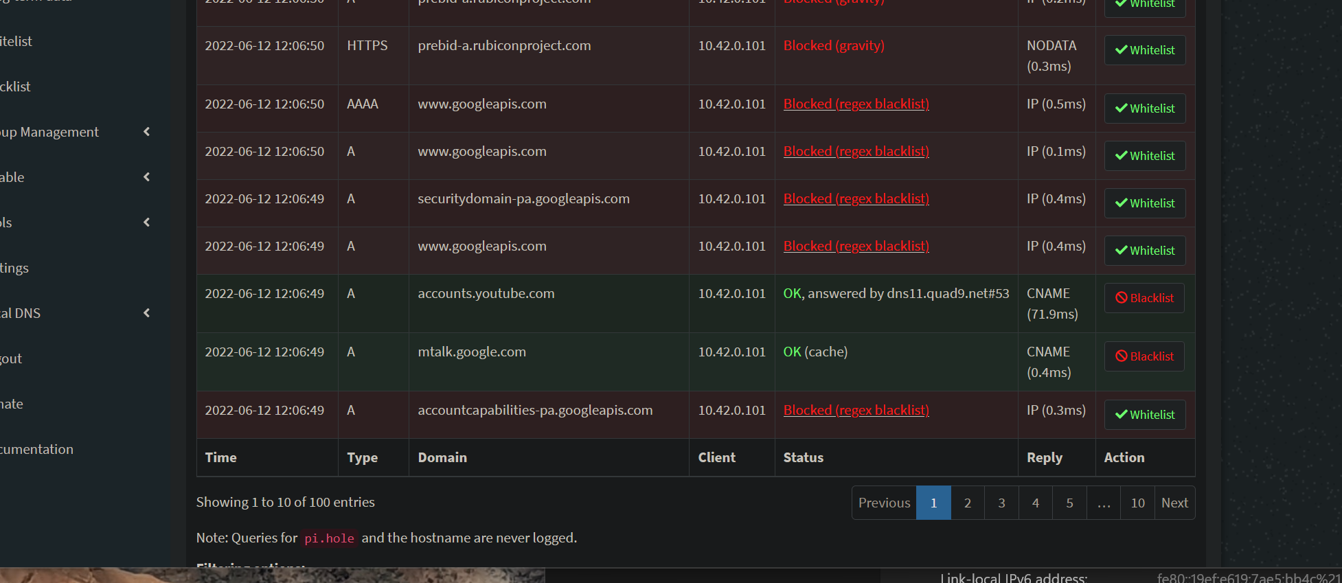

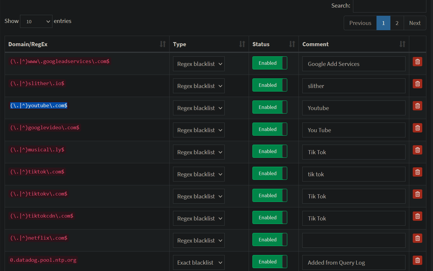

I add (\.|^)youtube\.com$ I would expect to see requests to youtube.com show up in the logs and be blocked.
The Post requests do not appear blocked

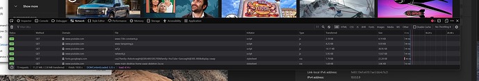

It is strange because when I turn off the regex I see the client sending requests to youtube...
But when I turn it on I don't see anything blocked and the requests seem to go through ok. Is there something funky going on here like the browser has some built in backup DNS? I am using Firefox.
Also the background on the way it is setup, My router is pointing at the PiHole Server as DNS so all of the requests through it "should" be going through pi-hole. The router is a netgear.
