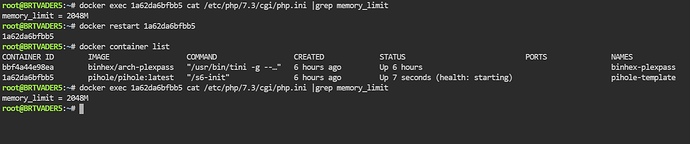

<1a62da6bfbb5> is the name of my pi-hole docker container (replace it with the name of your pi-hole container name)
<2048M> is the new amount of ram I set for my pi-hole conatiner (replace this with the amount of ram you want)
I used this to get the name of my pi-hole docker:
docker container list
results of command:
CONTAINER ID        IMAGE                  COMMAND                  CREATED             STATUS                   PORTS               NAMES
1a62da6bfbb5        pihole/pihole:latest   "/s6-init"               21 minutes ago      Up 6 minutes (healthy)                       pihole-template
I used to change the php.ini file:
docker exec 1a62da6bfbb5 sed -i 's/memory_limit = 128M/memory_limit = 2048M/g' /etc/php/7.3/cgi/php.ini
I used this to confirm the changes took:
docker exec 1a62da6bfbb5 cat /etc/php/7.3/cgi/php.ini |grep memory_limit
I then restarted the docker "container for pi-hole"
Which would have restarted the container and wiped out any changes you made.
I fixed the wording in my previous post.
From: I then restarted the docker
To: I then restarted the docker container for pi-hole
