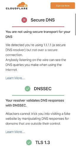

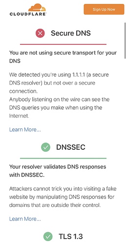

The issue I am facing:
You are not using secure transport for your DNS

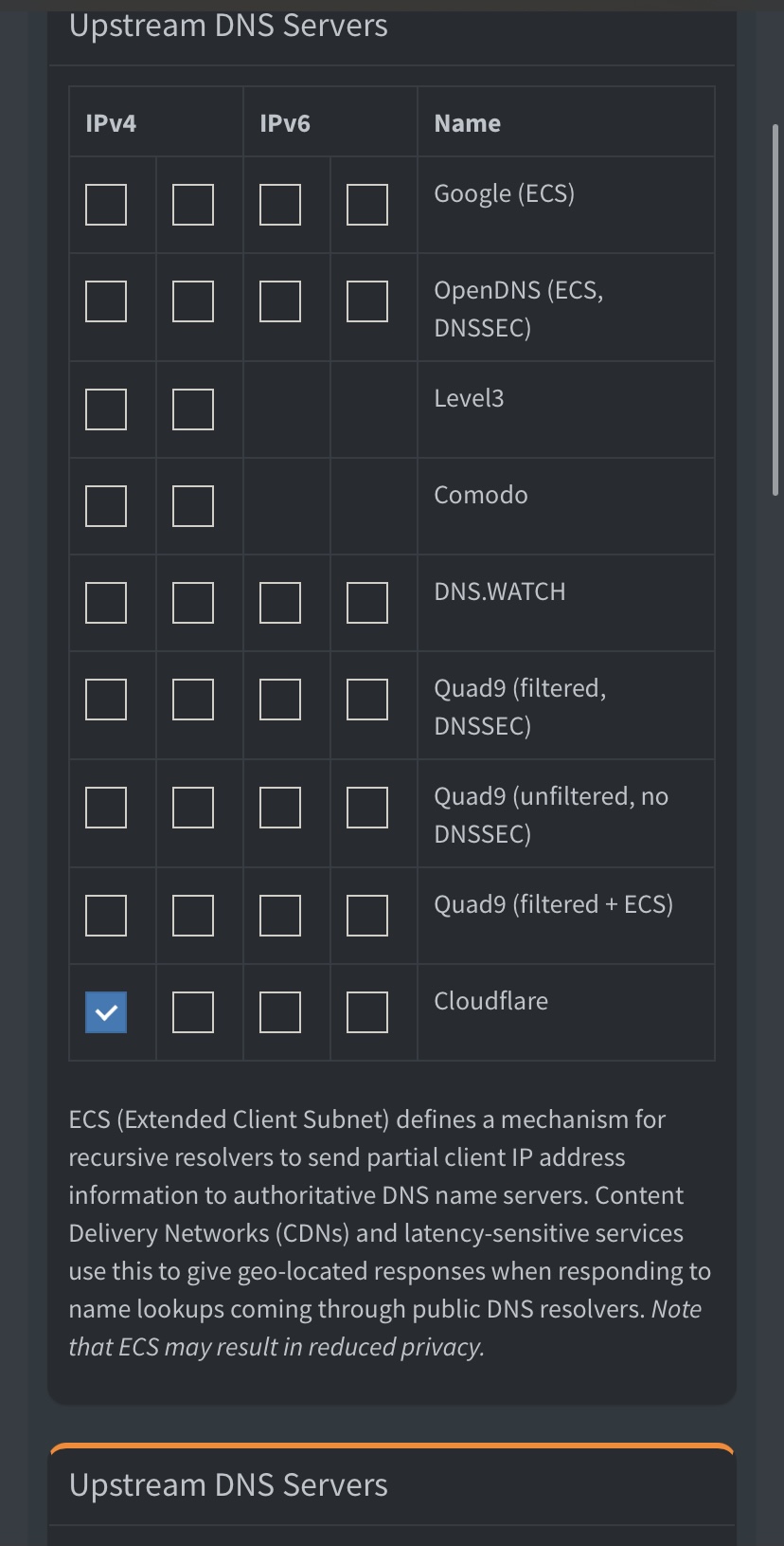

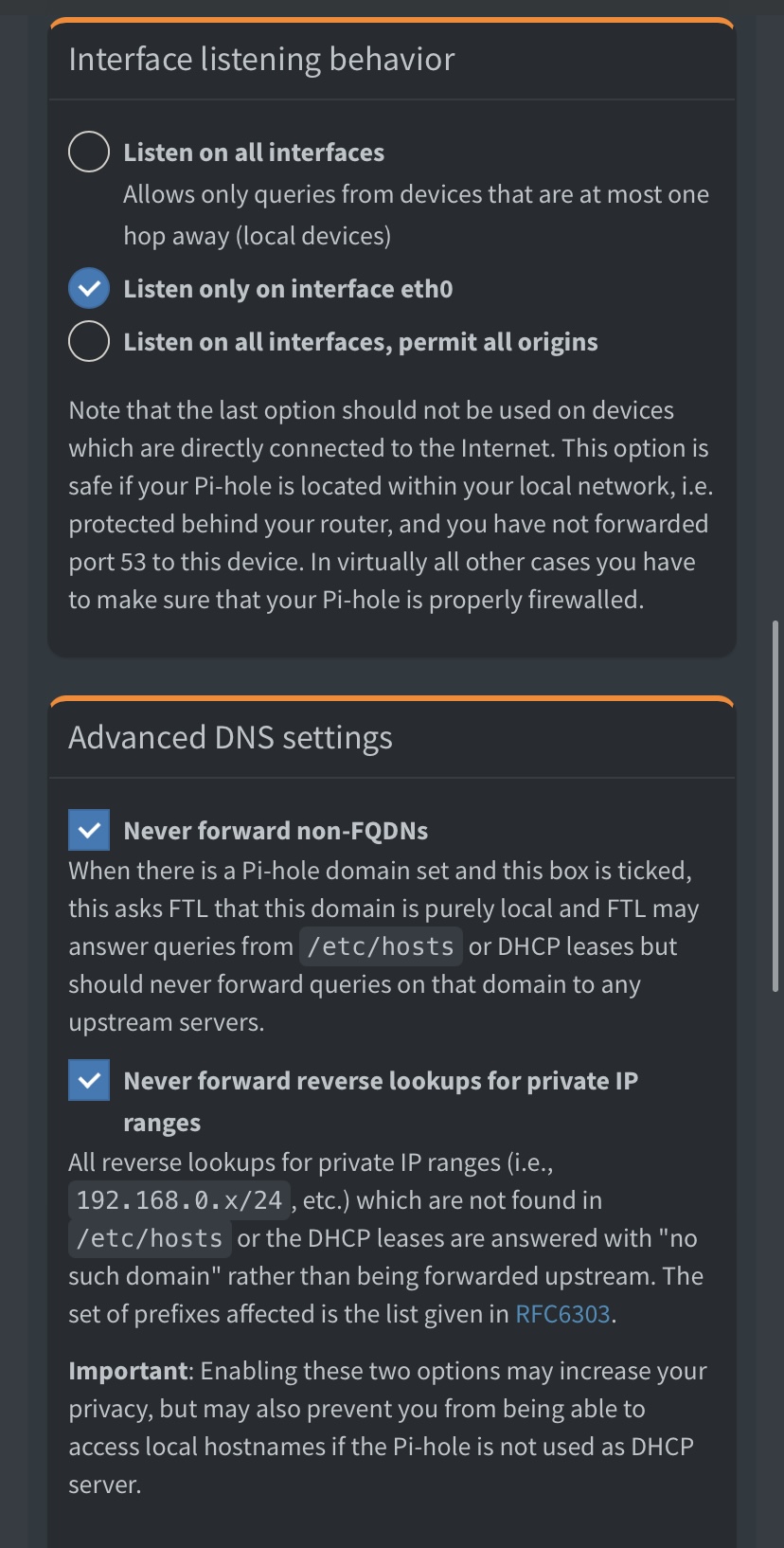

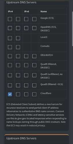

Ok it's all setup I used this tutorial Configure Pi-Hole DNS + Cloudflare DNS over HTTPS (DoH) on a Raspberry Pi - Nathan Catania

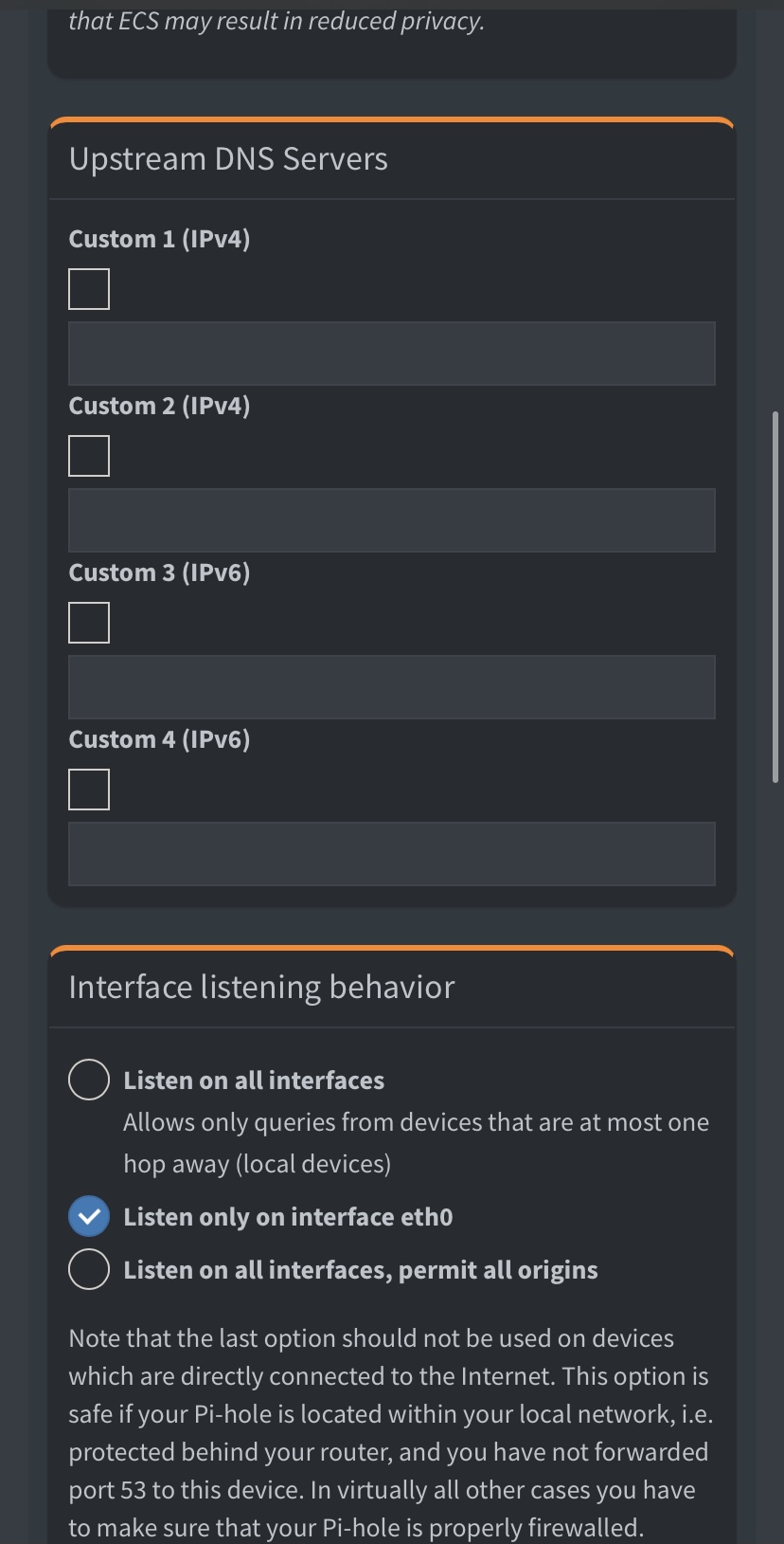

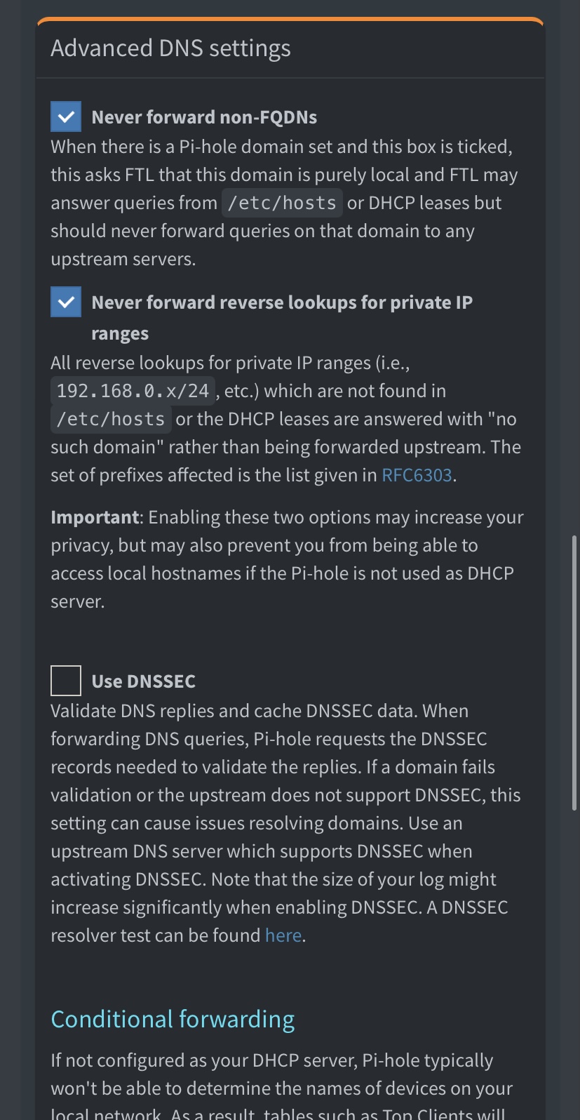

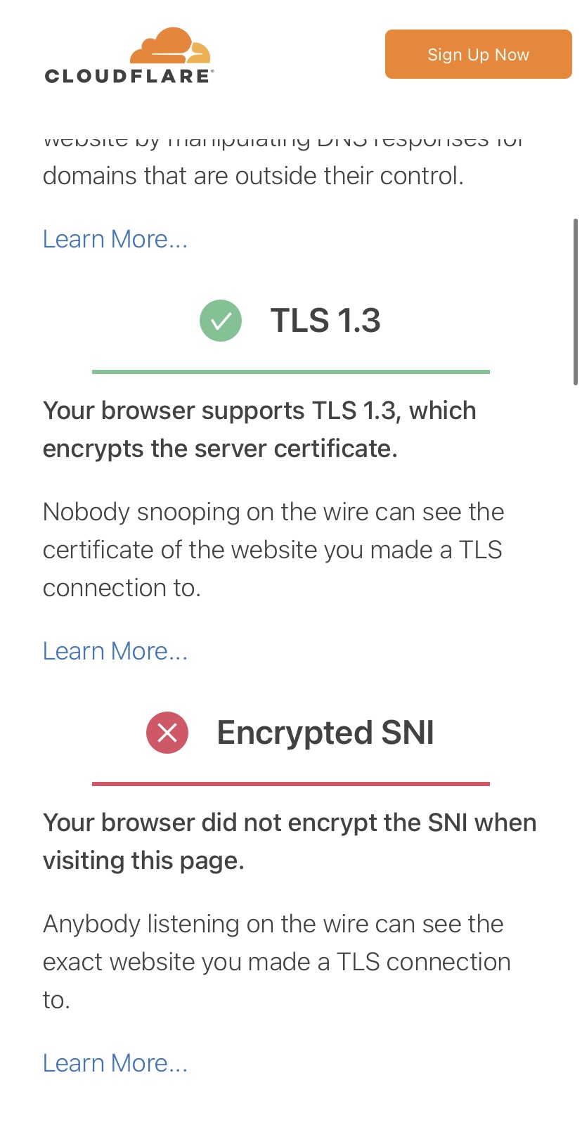

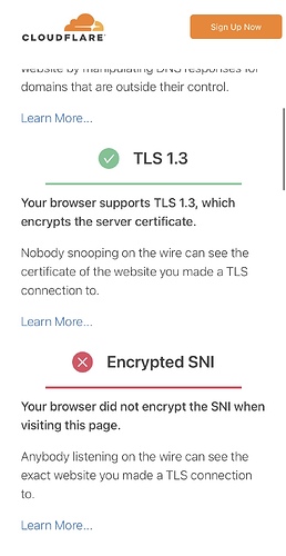

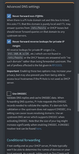

Using Cloudflare and I turned DNS sec off and ESNI checker is still saying it's insecure even though it's working I checked the status changed the upstream dns to 127.0.0.1#5053 and everything.
I also tried the esni checker on pi browser and still the same results
I checked the cloudflared status on the pi too and its working
