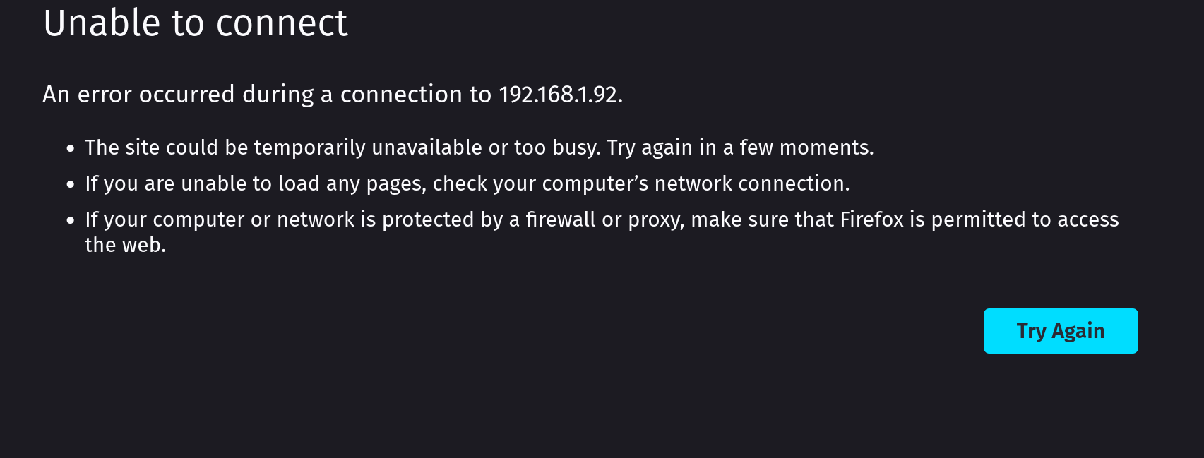

Test case: connecting to the pihole admin console remotely via:
http://192.168.1.92/admin
Android Client able to connect to pihole admin page via:
Surface Client unable to connect to pihole admin page via:
If I reload the page and check the network viewer on firefox:
The GET request to the above address yields NS_ERROR_CONNECTION_REFUSED in the transferred column.
The surface is however routing it's traffic via Wireguard to the Pihole (see troubleshooting below for evidence of this).
I am stumped as to why my phone is able to resolve my home LAN IPs but my Surface (running Pop-OS) is not.

So my Surface is routing it's webtraffic through Wireguard to the pihole which passes DNS to unbound during regular browsing but I can't access the pihole's admin console via it's LAN IP.
This seems to me like the problem is on the Surface but I can't put my finger on what is going wrong.

Your observation doesn't sound like a Pi-hole issue:
That error message tells us that your browser successfully resolved the DNS into an IP.
But something refused the connection to that IP.
If it's not a local firewall, then I'd expect your wireguard's MTU to be too large (which is a somewhat common issue with Wireguard connections to web servers - pops up quickly when you search for that error in a Wireguard context).
You should probably try changing your Wireguard's MTU to 1380 or even 1280.
If that's not fixing it, you may want to consult Wireguard's support channels also. :wink:
